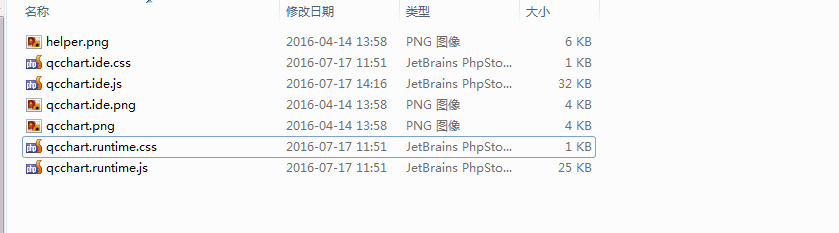

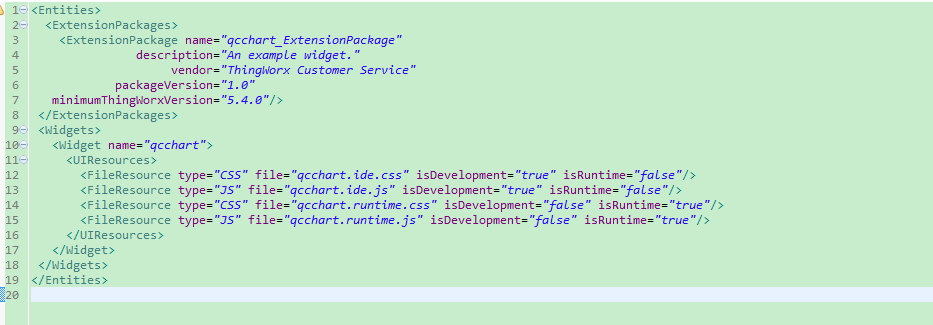

i created a widget with a xml file and import into thingworx ,but always with the error message"Extension must have a metadata.xml file."
the content of the xml is
and my widget file list is so what is the reasong i failed to import this widget to thingworx

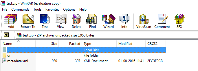

September 29, 2016
your extension package should contain a folder named ui and metadata.xml.
fliu11-VisitorAuthor
September 30, 2016
