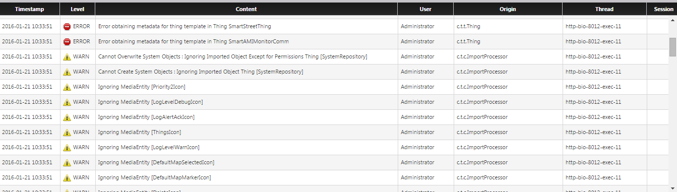

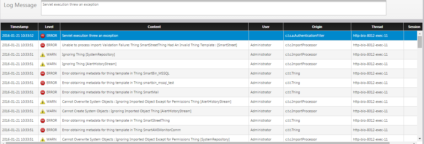

After trying what Aanjan suggested and you are still having issues, check the Application Log by clicking Monitoring then Application inside ThingWorx. It will bring up a new browsing tab that you can use to look through the logs. Check to see if there are any errors about importing.
radhikari1-VisitorAuthor
January 21, 2016
These are the logs I found. Please suggest what i should do.
22-Sapphire I
January 21, 2016
Looks like you are missing some extensions? Did you import the necessary extensions before importing the Entities?
January 22, 2016
Hi, so.. since i tried importing entities separately. Did not work for the most part. But then i started to import through the data shapes.. then thing shapes, then templates.. so on and so forth. so finally i was able to import it but you know, step by step. Not as a whole.
