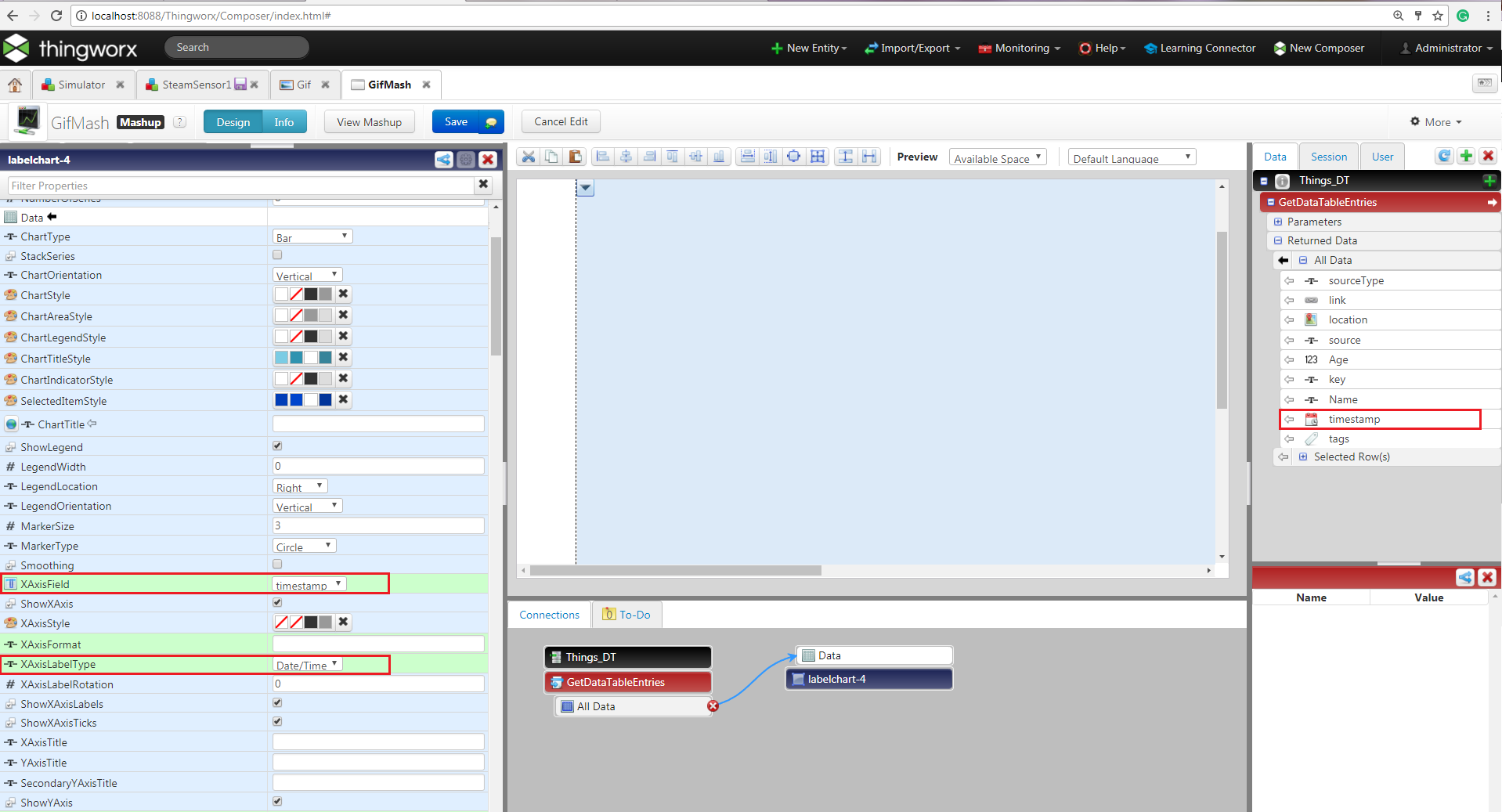

Is it possible to show info table property to label chart? I have mapped the infotable property to label chart but I didn't see my timestamp column while configuring properties of widget. Can anyone suggest some solution.

I have tried to use non-numeric data as axis range without success. As per my understanding, you can set only numeric values in X-Axis.  Let me know if you find a way to use StringTimestamp values in X-axis.

Hi isha,
First of all, please check your infotable out-put datashape, make sure there is a timestep column.
As I checked Lable chart X-Axis can be set to timestep.
Should you have any concern, please feel free to let me know.
