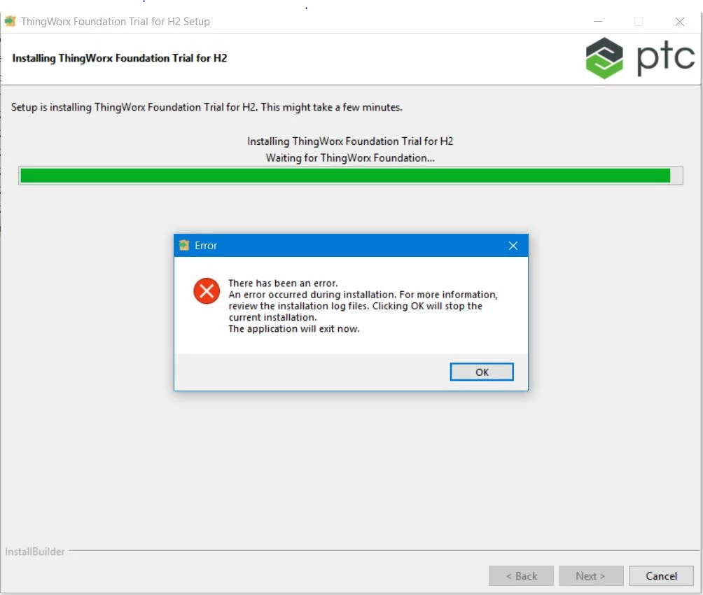

Hi Team,
    I am using windows 10  64 Bit Enterprise version. When I trying to install "ThingWorx-Foundation-Installer-h2-trial-Windows-9-0-0" it ended up with some error message.
My java version is :
C:\Users\eaz>java -version
             java version "1.8.0_162"
            Java(TM) SE Runtime Environment (build 1.8.0_162-b12)
            Java HotSpot(TM) 64-Bit Server VM (build 25.162-b12, mixed mode)
 Here I attached the error message and error log file.

@AE_9699465 ,
1> From the log file you attached, it appears that the Installer is using the below JDK:
  --- C:/Program Files/Java/jdk-9.0.1/bin/java.exe
Per the path name, it sounds like that it is JDK 9.0 instead of 1.8.0_162. Please check your system environment variable PATH and JDK_HOME to make sure it points to the correct JDK/JRE version
2> Have you tried to install Thingworx on the system before? It seems that the below is already there. If you try to reinstall it again, check the below path and delete it if it is there before you re-install.
      D:\Program Files (x86)\ThingWorxFoundationH2Trial.
3> Run the installer with "Run As Administrator"

Ya...yes..Installed by run as Administrator .

Thanks for your information.
Ya Yes. Run the installer as a "Run As Administrator".
After uninstalling JDK-9.0.1, it's installed fine.
Thanks ...

What is your $PATH set to? If it isn't, try set it to %\jdk..\jre..\bin
and check that you can access keytool from the cmdprmpt
I had the same error message and this worked for me. Thread below:
https://community.ptc.com/t5/ThingWorx-Developers/Unable-to-install-ThingWorx-Foundation-Trial-v9/m-p/696612

In my system, I have installed JDK-9 also. After uninstalling JDK-9, it's installed correctly.
