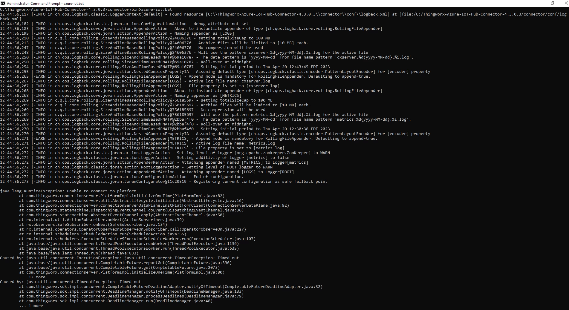

IoT Hub Connector setup throw Unable to connect to platform
I have been following article https://community.ptc.com/t5/IoT-Tips/Connect-Azure-IoT-Devices-Part-1/ta-p/833021
As per article version of HubConnection Extension should be azure-iot-hub-adapter-extension-4.2.0.4 but I found for thingWorx 9.2 has version "Thingworx-Azure-IoT-Hub-Connector-4.3.0.3".
I also notice that azure.iot.conf (below) has just 3 properties but article has 10. I dont know from where read value for "hub-thing-name". When I run "azure-iot.bat" I get "java.lang.RuntimeException: Unable to connect to platform" error.
Please help to point to most current article/lab or fix existing one.

Apr 21, 2023 4:21 AM UTC
Hi @SY_10660763
From error message it looks like Azure Connector not able to connect with Thingworx Platform. Please check Thingworx URL and Port Number
You can also check support page for more information
