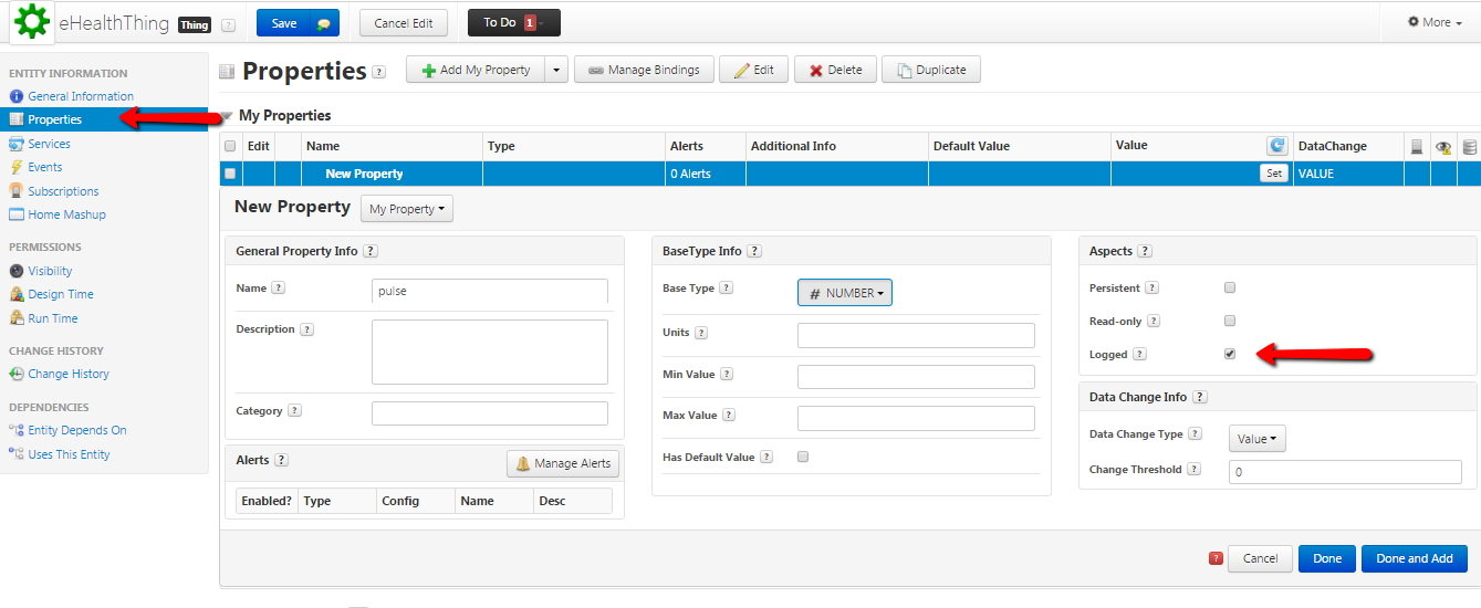

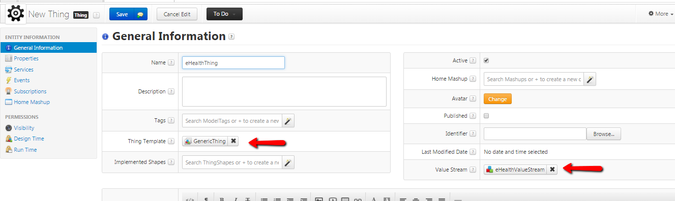

Hi
I have a thing with template "Generic thing". How can i add a Label chart widget in the mashup for a generic thing? For a Remote thing it is working perfectly well.
I tried adding so, But after binding with the QUERYPROPERTYHISTORY, it does not show anything in the chart. Can anyone help me out in solving this issue?
January 11, 2016
Hi Suprya V,
To be able to have data stored and see it when calling the QueryPropertyHistory service on a thing you need to:
1. Create a value stream and associate it with the thing for which you want to retrieve property values.
2.Mark the properties for which you want to have historical data as logged. To do this go to the Properties section of your thing and edit each of the properties that you would like to have logged. Check the logged checkbox situated on the right side of your screen:
3. Save the Thing and use its QueryPropertyHistory service in your Mashup.

January 11, 2016
Thank you Veronica.
I tried doing so.But the Label chart is blank.Check the pic below
1) added a value stream
2) made the property logged
What should i do??
sv_011-VisitorAuthor
January 11, 2016
Now i am getting the chart..Thankyou Veronica!
