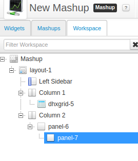

Hi, I'm doing some mashup designs.
I have some trouble in doing some layout.
Is there any way to align a panel in the column(in a horizontal layout) in right aligned??
September 19, 2017
Hi Soon, could you please clarify if you wish to right align the panel itself or the contents of the panel?
Ascherer17
January 15, 2018
I'm wondering about this as well.  If I'm thinking about this correctly, in a "Responsive" mashup, the only thing a panel can be moved around inside is another panel.  So the panel itself would be the contents of a panel.  Otherwise the panel would expand to fill a responsive container.
Do you have an explanation of how to right align/anchor contents of a panel to the right side of the panel then?
January 15, 2018
If you put a panel inside another panel you will see some properties to anchor the inner panel
       Unfortunately you can only align 'left' or 'centre'. I don't think there is a 'right align' option.
