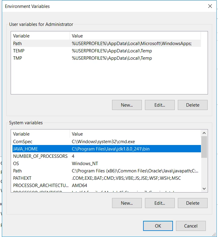

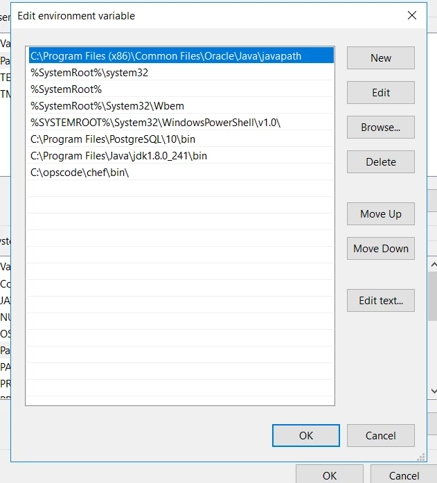

attached my path settings
Could someone help me with this?

Hi @Giovanni.
Try removing JAVA_HOME from the environment variables and change the path to use the JRE instead of the JDK.  Before re-running the installer, you'll need to make sure artifacts from the previous attempt are removed, such as the service, etc., otherwise the next attempt may also fail.
Of your next installation attempt fails, once you get the message regarding the failure, hold off on hitting the OK button.  Then navigate to the installation folder on the file system and search for the installer logs.  Attach that here and then you can hit OK to proceed with the cleanup.

JAVA_HOME should not contain bin, please change JAVA_HOME path without bin, e.g. C:\Program Files\Java\jdk1.8.0_191
After this, redo the installation on a clean VM.
