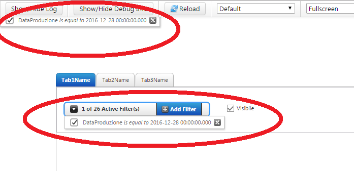

Hi, i notice an issue with data filter inside tab.
Please watch at 2 images attacched.
The as is:
- 3 tabs, each one inside has a data filter widget
- each tab has a service to get a query for set the default filter for each data filter
- each tab has a service to get the data for populate columns in data filer
The issue:
      if the tab is only 1 all is ok, with more than 1 tab ( more than 1 data filter), the popup for displaying fields in query widget , appear in the left corner of the screen not near the selector. i think the one i see on the top left corner is the one inside tab 2 or tab 3.
please help

Hello, seems this may be a bug. What version of ThingWorx is this? You're sure there isn't a rogue data filter in the background of your mashup or something like that, right?

The version is 7.1.3-b14
I think it is a bug, Yes, i created this mashup only for testing it and i'm sure i have only 3 data filter widget. The problem appear when a service return the query for input query in a datafilter hidden. To solve this i inserted a validator that trigger the service for having the default query only when the tab selected is the one containing that widget.

Wait, I just tried reproducing this in 7.1.5, and couldn't, but I think I don't understand what you are doing exactly. Can you take a picture of your bindings for your first data filter widget?
