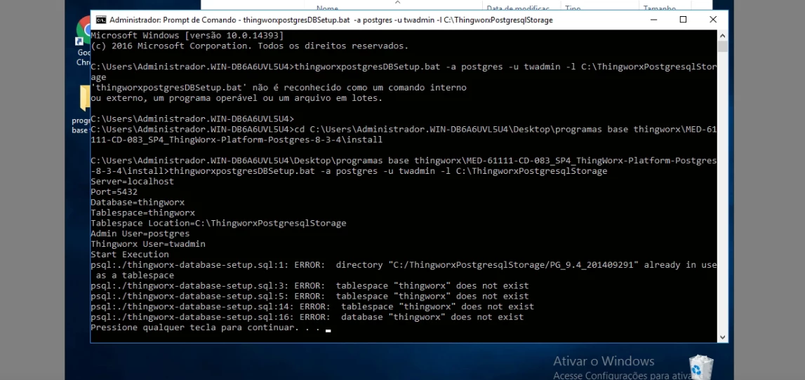

January 15, 2019
I was able to execute the command entering the folder where the .bat is located. But he is returning this error to me.
Support
January 15, 2019
Hi @SamuelRodrigues.
If you ran the script more than once, you may have already created the tablespace.  Would recommend dropping the thingworx database and tablespace and starting over.
