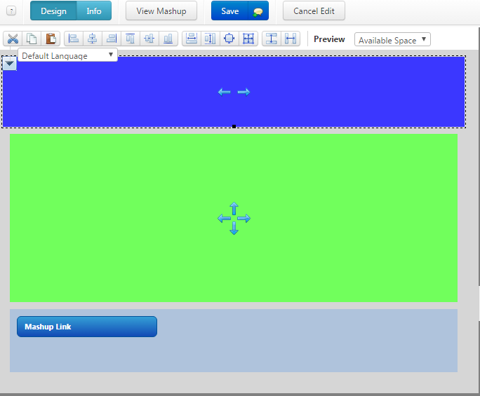

I am having issues with the layout footers.  The footers are appearing over the top of the first row.
I have a screen setup that has a header, a footer, and one row.
Here is how I have my layout configured in Composer (color coded to see the regions better)

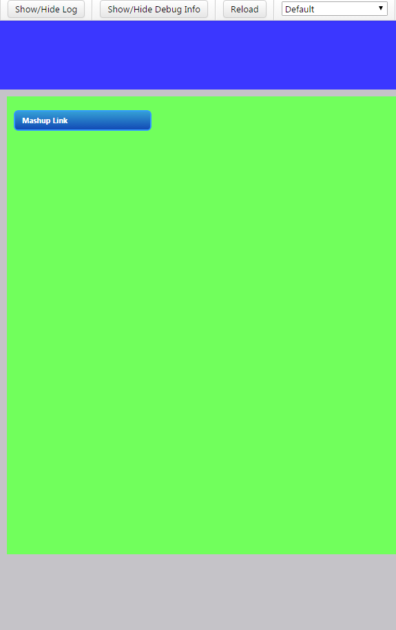

Here is what my mashup looks like when I view it:
Any thoughts on how to correct this issue?

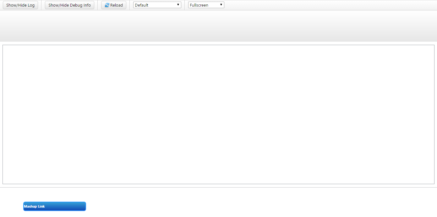

I think this is a bug on ThingWorx 7.2.3-b48 at least. I didn't test all the 7.2 versions, but I did on the exact same version that you are using. However, I also tested on 7.1.2-b6, it works fine as you can see below.
