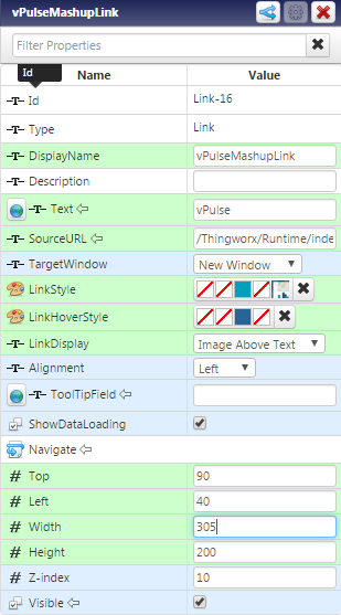

Link widget Text does not display below the image when viewing mashup.
Here are the properties of the Link widget:
LinkStyle style definition has a 304x170px image specified.

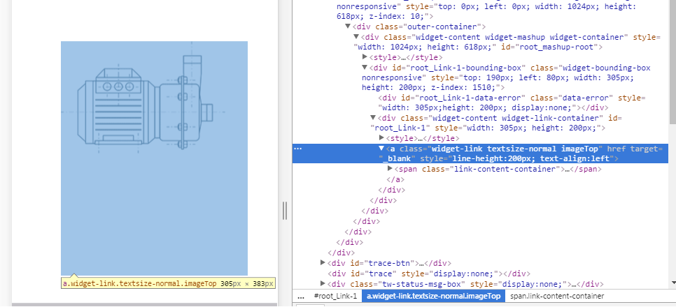

The issue appears to be the CSS styling "line-height: 200px;" on the <a> tag in the generated HTML (see below). If I remove the line-height style (using Developer tools in browser), it works as expected.

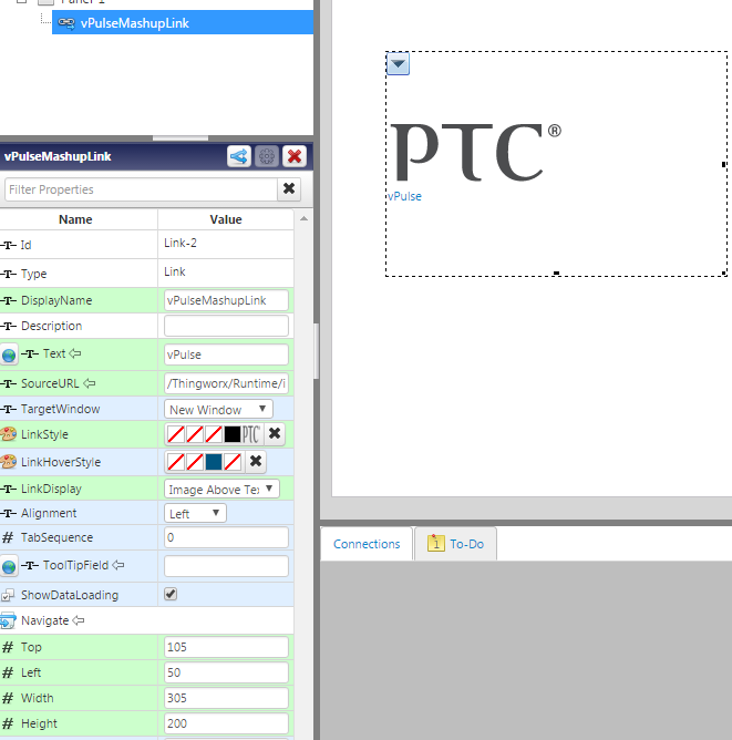

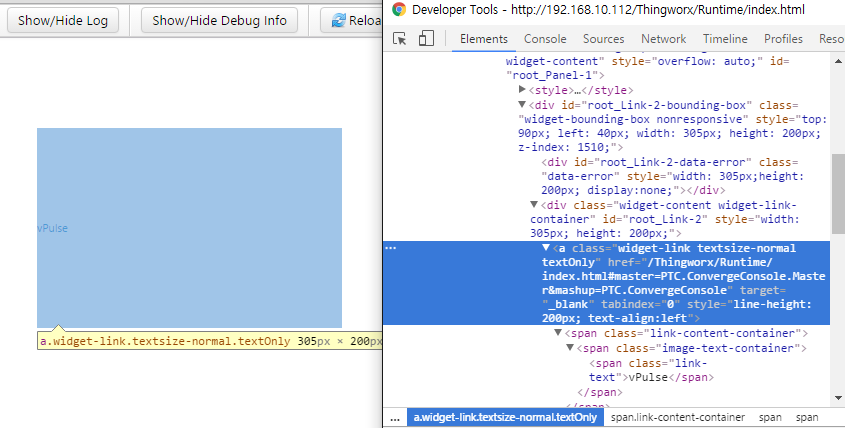

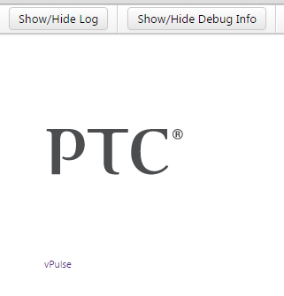

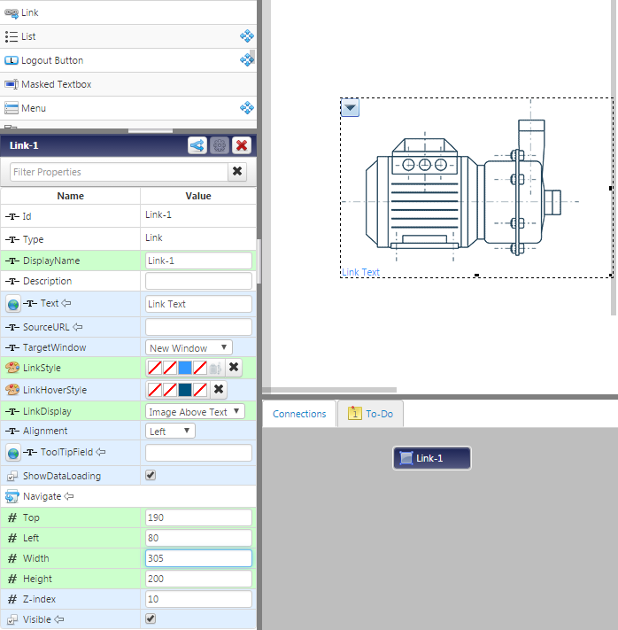

Which version of ThingWorx are you working on? I tested on my ThingWorx and works fine as below. Mine is 6.6.2-b418.

Hi Daniel,
Thanks for your reply. My Thingworx version is 6.5.0-b460.

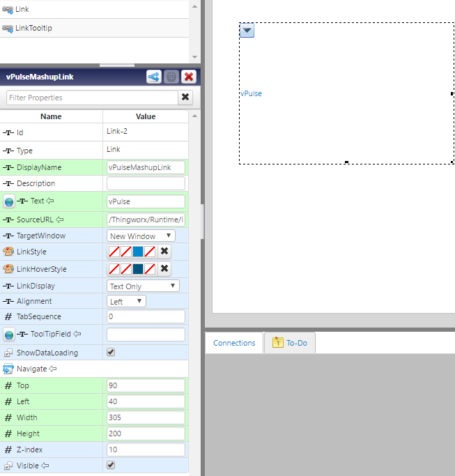

I have verified that version 6.5.0 works as expected when LinkDisplay is set as Text Only, but I'm trying to use the image option.
Have you tested with an image above the text in 6.6.0?
Image is added to the custom Style Definition used for the LinkStyle property.
And LinkDisplay property is set to Image Above Text.
Double height container and "Link Text" text is not visible.
Shane

Yes, I tested with a custom style with image on 6.6 as below.
