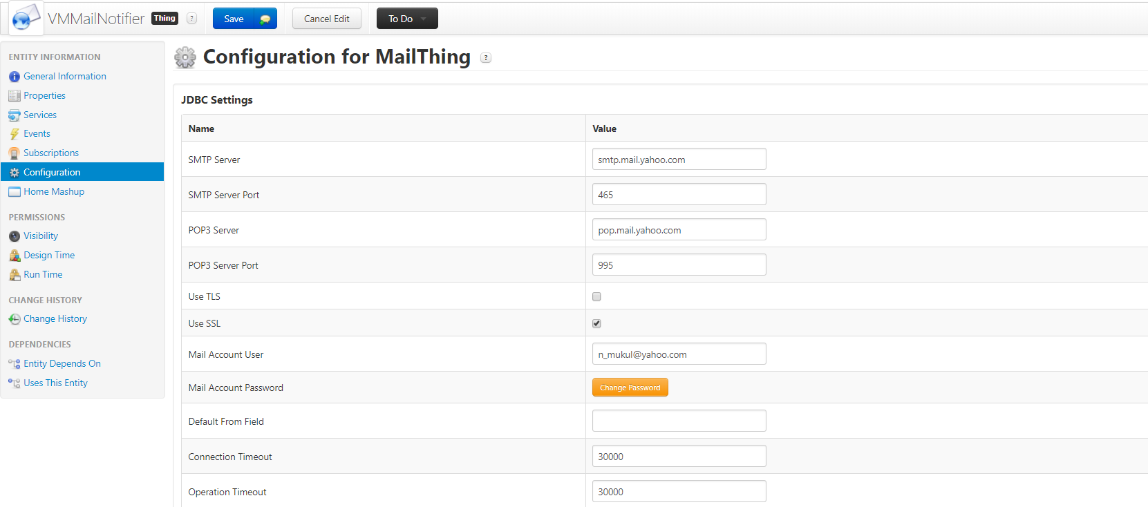

You should supply POP3 server and port according to your account details to which you are configuring your mail thing .Like I have yahoo account (Mail account user) so these are my settings for this .

Mahendrs, you should be checking the Gmail's POP/IMAP settings, see here https://support.google.com/mail/answer/7126229?hl=en
The error highlights that your machine is not able to initiate connection on port 465, other way to test would be to use Telnet see if it allows you to make connection else you might have to allow those from Firewall.
There's no other setting needed from ThingWorx side, other than what you are already configuring.
December 28, 2017
Can you please check your Pop3 Server ,it's pop3.gmail.com instead pop.gmail.com .
Also you need to turn on Allow less secure app in gmail settings to allow thingworx to login into your account and send mail from there .
Rest I have tried with the same settings as you have in screenshot and it's running fine for me .
