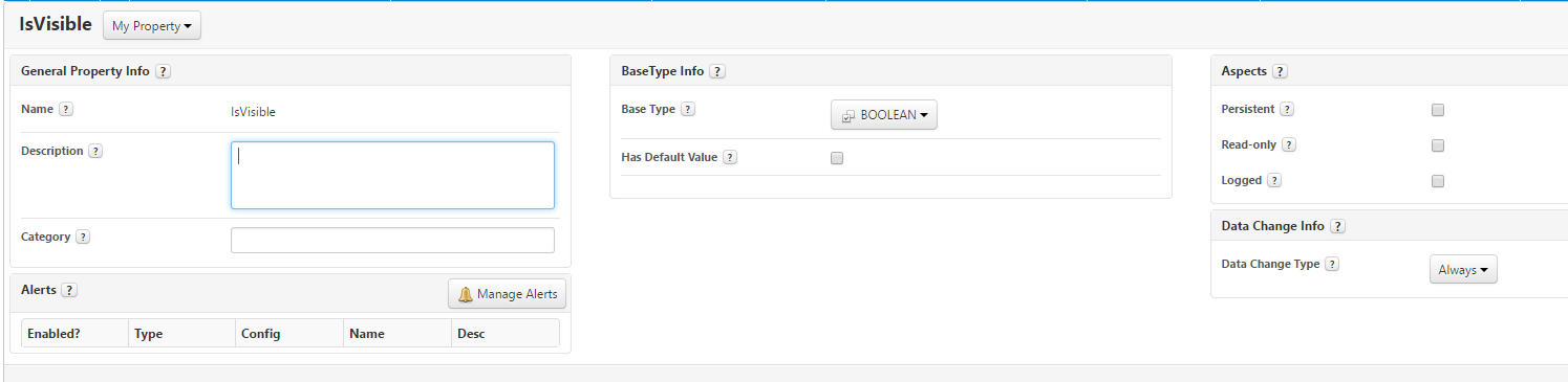

Currently I am working on two google maps widgets which are superimposed. The two google maps widgets are showing exactly the same locations, but
with different marker icons. What I want to do is to make the overlying google map visible/invisible based on the value of a boolean property which is defined in my helper thing.
In the following, I show you how I tried to realize that:
1) I have declared a boolean value named "IsVisible" that emits an event every time the value changes:
2) I have implemented a custom service which gets executed everytime a specific value has changed and sets the "IsVisible"-property to the correct value.
3) Then I have binded the event "ServiceInvokeCompleted" of my custom service with the imported service "GetBooleanPropertyValue" and have defined the
     needed PropertyName parameter as "IsVisible".
4) then I have binded the boolean Output of the function "GetBooleanPropertyValue" with the visible-property of the overlaying google maps widget.
Any suggestions on how to solve this problem?
Thank you so much in advance.

Hi Theresa Lichtenberger​,
On what step are you facing issue?
June 14, 2017
hey @Ankit Gupta!
it seems that the map is just going gray instead of invisible.
Unfortunately, I do not exactly where the mistake could be. Maybe you have an other approach to solve this?
Thank you btw for your superfast answer. This is very much appreciated .
best wishes,
theresa
June 15, 2017
I checked this scenario on my local instance and I was able to reproduce this issue. It seems that Google map rendering happens on Mashup load and the invisible Map remains un-rendered.
Is there any specific reason to use two different marker icons for the same location. Could you please share use case in more detail?
