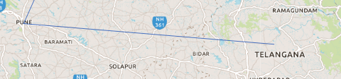

Hi Folks,
I want to display markers for every location on a ROUTE.
There is a property of "Show markers between...." in the widget but that doesn't work on a ROUTE data and getting only a line drawn between immediate locations.
The only marker is visible is at the latest/End location on a ROUTE data.
August 11, 2017
Tie the route data to both the RouteData property and the Data property, and set the locationField property and the routeLocationField property. Make sure ShowMarkers is selected. This will show all markers on the route.
