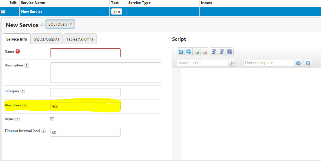

Hi Warunraj,
As Sushant noted, you need to check how many rows returned from your DB query? If it's more than 500, you have to manually configure the "Max Rows" in your customized DB query service, and below is the snapshot where to configure it for your refrence.

Anna, I did try this option and even set it to 1000; however, that did not help. I dont see any change in output.
