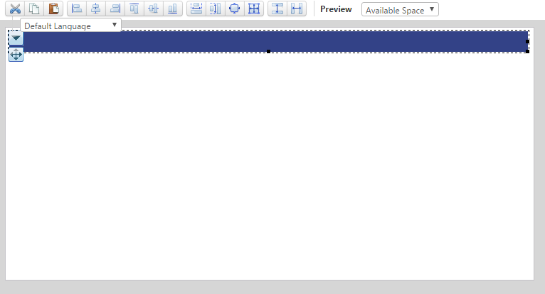

I would like to ask about if i chose the dynamic Mashup, so the visualization will be adapted automatically to the screen resolution?

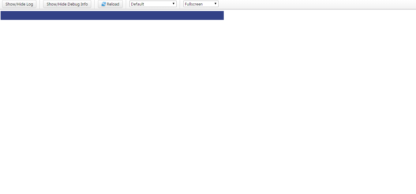

As this is my working arera but when i make view mashup its not covered all the screen

That looks like you have a fixed-size Shape on a dynamic-sized Panel in a responsive mashup.
Widgets will only be responsive when they are dropped into a dynamic region.
March 28, 2017
Hi Karim BADR​, Try using layout widget to create various columns and rows. Then place your responsive widgets in the cells and it will cover the complete cell.
If you use a Panel widget anywhere in the Responsive Mashup; that part will be Static.
