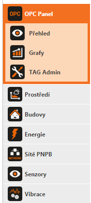

Hi Guys,
I have used TW 6.5.3, I have tried 6.6 and now 7.0.1 both of which are having problem with styling.
MenuSelectedStyle does not work. It worked at 6.5.3. Now, no matter which style I use a selected SubMenu does not change. On the left side is what it looked like in 6.5 and on the right side is what it looks now (since 6.6, so far as I can tell). It kind a bothers me. Can anyone confirm this behaviour. Perhaps some workaround?
Thanks a lot guys.
March 30, 2016
Just to check, are you missing that solid color or the border around it? The menu item on the second picture seems to be missing 'Line Color'; which is the border.
tcoufal1-VisitorAuthor
March 30, 2016
OPC Panel and KAUB2G are both nested menus (submenus). If the are selected (expanded) a MenuSelectedStyle should apply. Exactly like its on that first picture. However since 6.6 this styl does not seem to be working at all. KAUB2G  + KAUB2G3 should like the OPC panel...Also there is no visible spacing between Menu icon and Submenu Icon.
My menu style definations are exported and imported, so there should be difference at all.
March 31, 2016
Tomas, can you create a support case for this? I tried replicating the behavior, but was unsuccessful.
