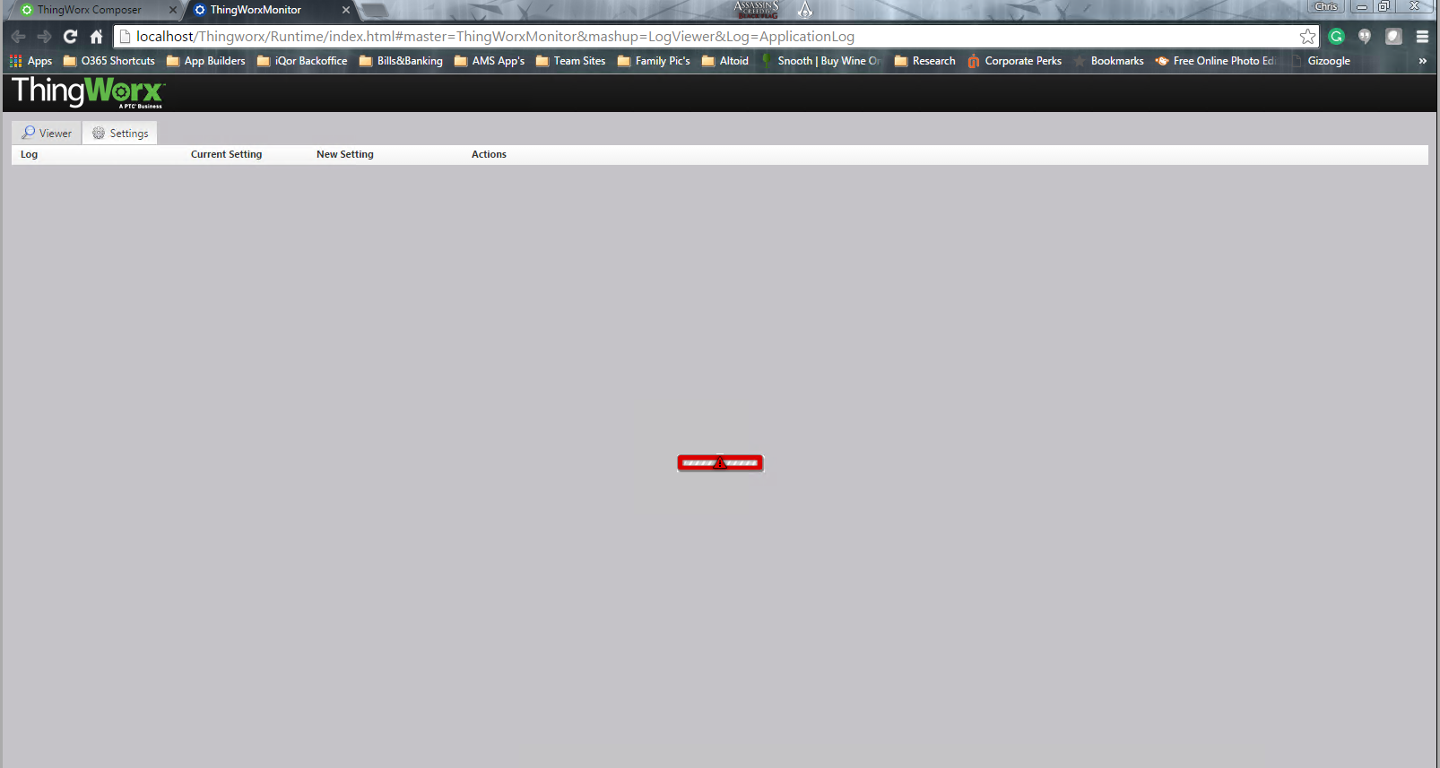

We've upgraded to v7.1 of Thingworx and I'm attempting to not make everyone an Admin.
However, it seems without access to Administrators group; users can't get to Monitor through Composer and actually see log data. They can see and reach monitor mashup, but not the actual logs. See screenshot.
I've tried several things with no success, I look forward to the normal great guidance on this.

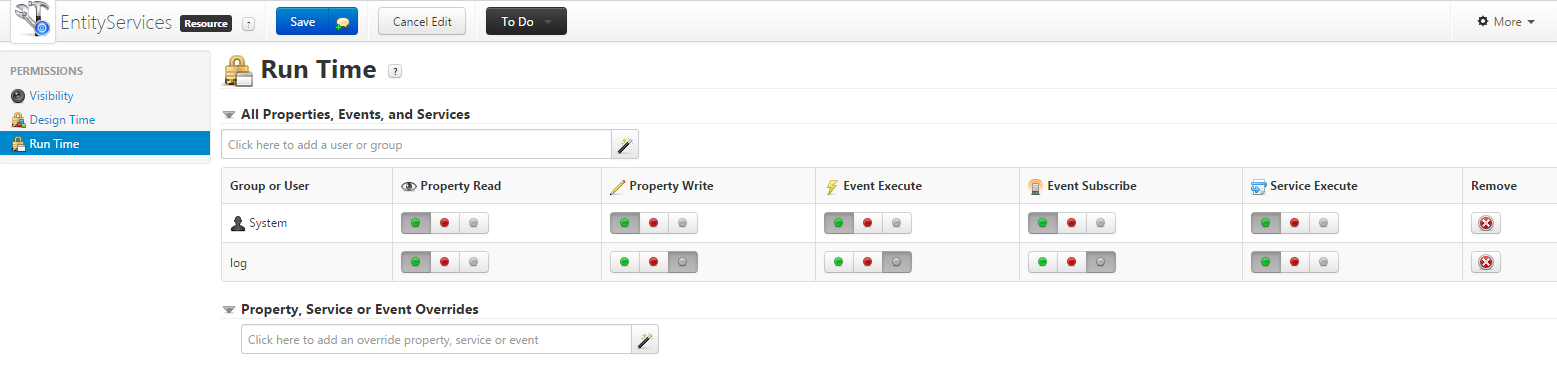

SOLUTION:

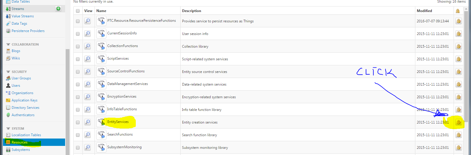

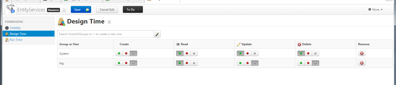

1. Set EntityServices Resource collection permissions:
1b. Now the user I created and used in my test scenario is called “log” (please disregard “System” user as it’s for a different test scenario):
1c. Set Visibility, to the "Development" Org.
2. Repeat STEP 1 for the Logging Subsytem and System>Logs Collection.

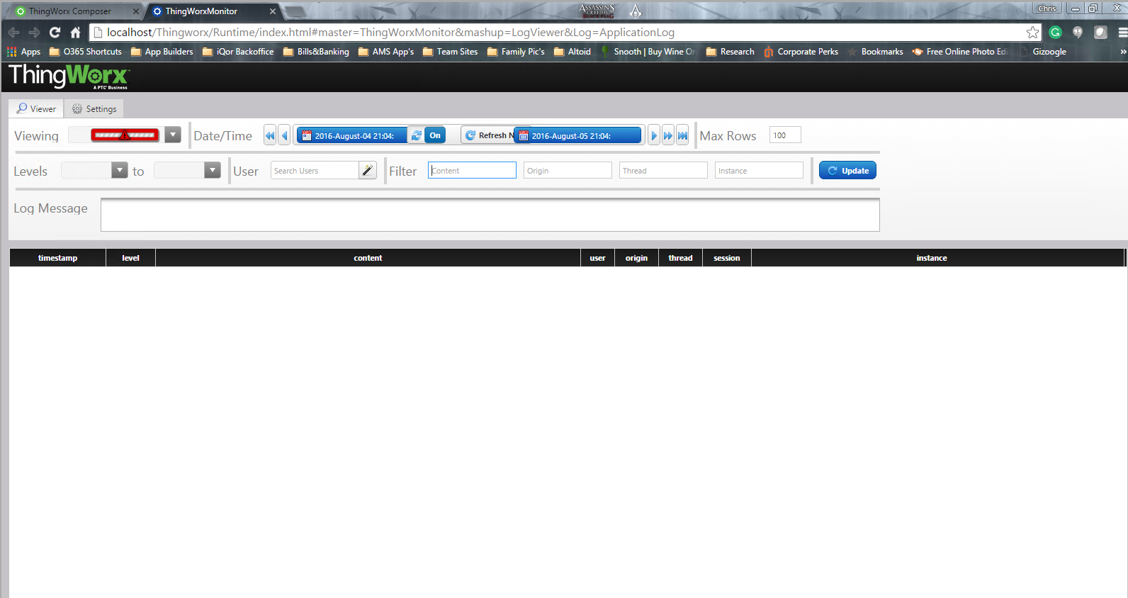

Hi Christopher,
By looking at the screenshots; it seems that user does not have access permissions to System->Logs-> ApllicationLog and other logs.
In general; user does not have access to various entities related to log viewer Mashup. You can login as Administrator in a different browser and check the Application logs when user try to view to logs. There will be multiple error generated for permissions. You would need to give access to all those entities to the user.

Chris, just to check, have you set permissions on the 'Logs' entity? This is available under the 'System' section at the Composer's homepage. You would need to give Visibility permissions and Service Execute permissions on Runtime permissions to display and query for logs respectively.
