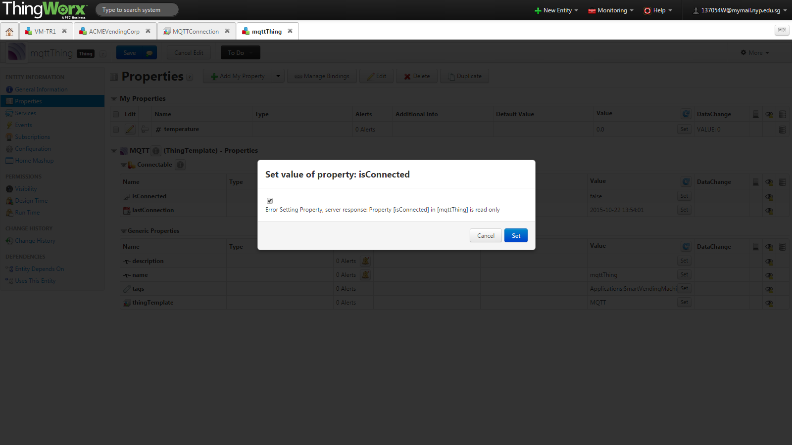

Hi just wondering why when i set it to true it shows me this on the isConnected  : Error Setting Property, server response: Property [isConnected] in [mqttThing] is read only?

ShunCai, that is a system property, which is why it is set to read-only. The property will change to true once your MQTT Thing is actually connected, and will stay at false if your MQTT Thing is offline/ disconnected/ not connected.
