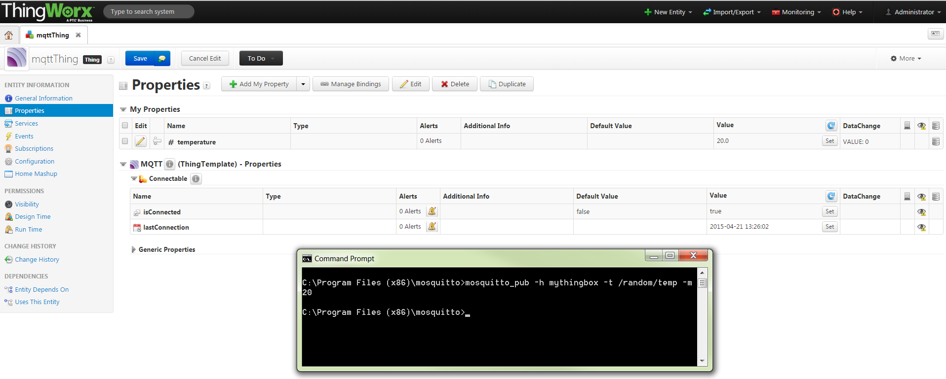

  • Download the MQTT extension from the PTC marketplace
  • Import the saved zip file from the Import/Export menu tab (Import/Export > Extension > Import) in the Thingworx composer.

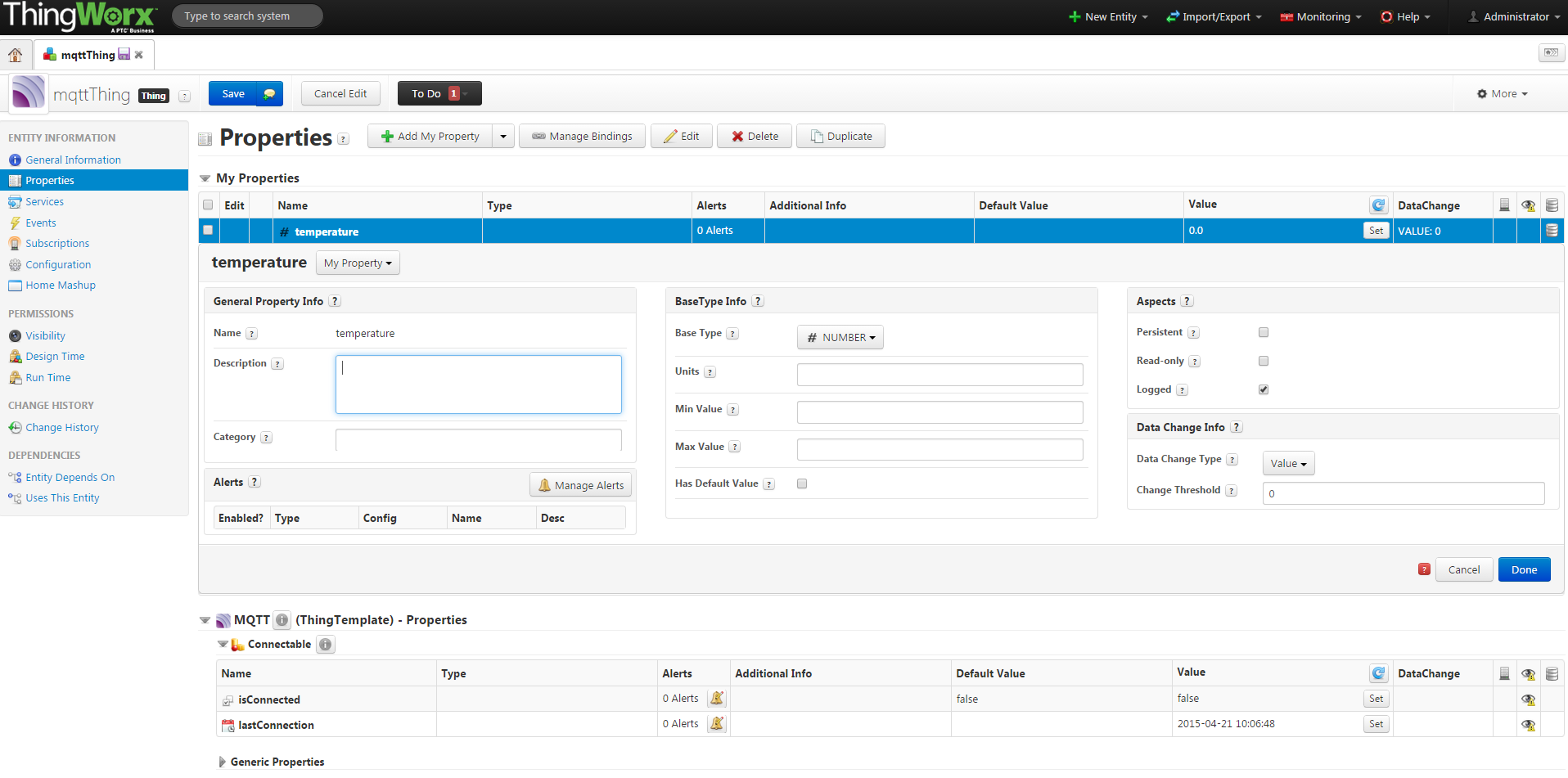

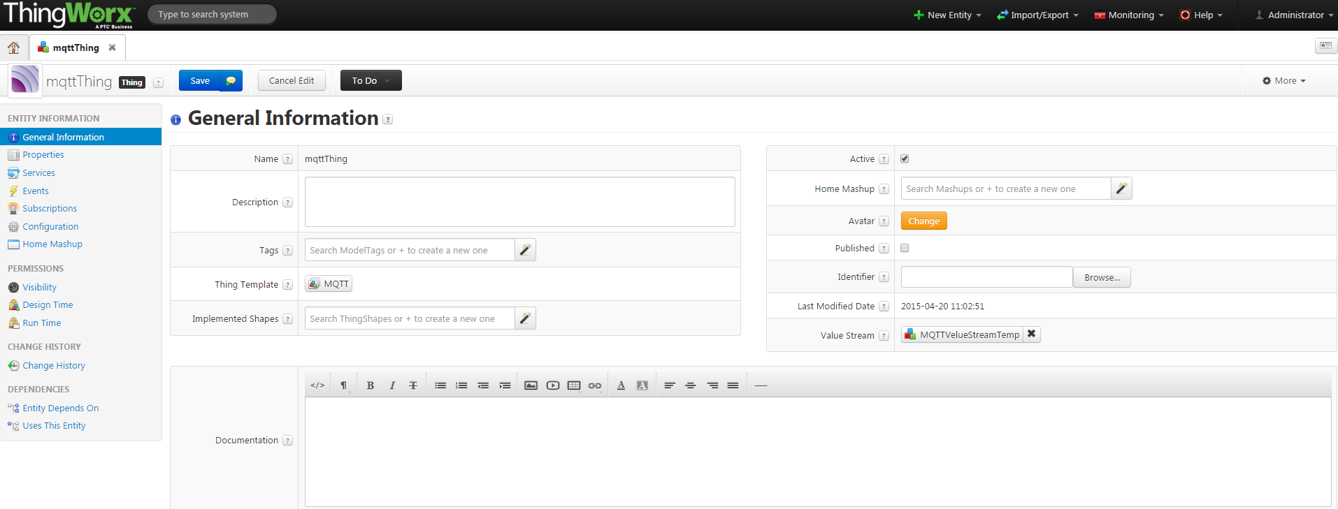

  • Create a new thing and choose the MQTT template when asking for Thing Template in the General Information page

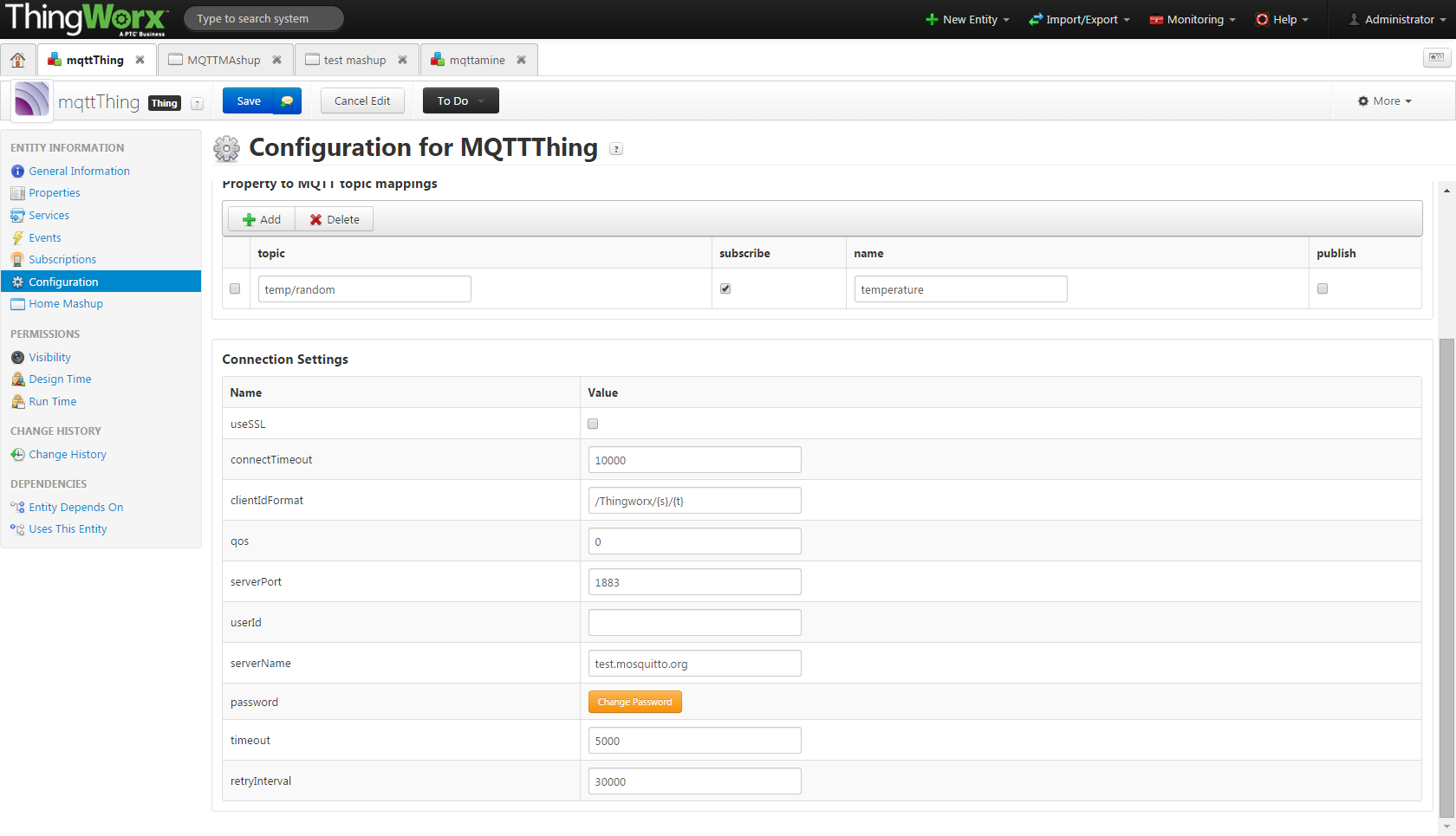

  • Create the different properties related to the topic you wish to use (publish and subscribe) on the Properties page (e.g. temperature).
  • To record the value history of a property checks the Logged box and add/create the value stream name in the General information page.

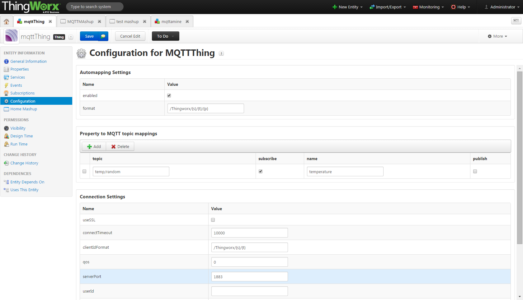

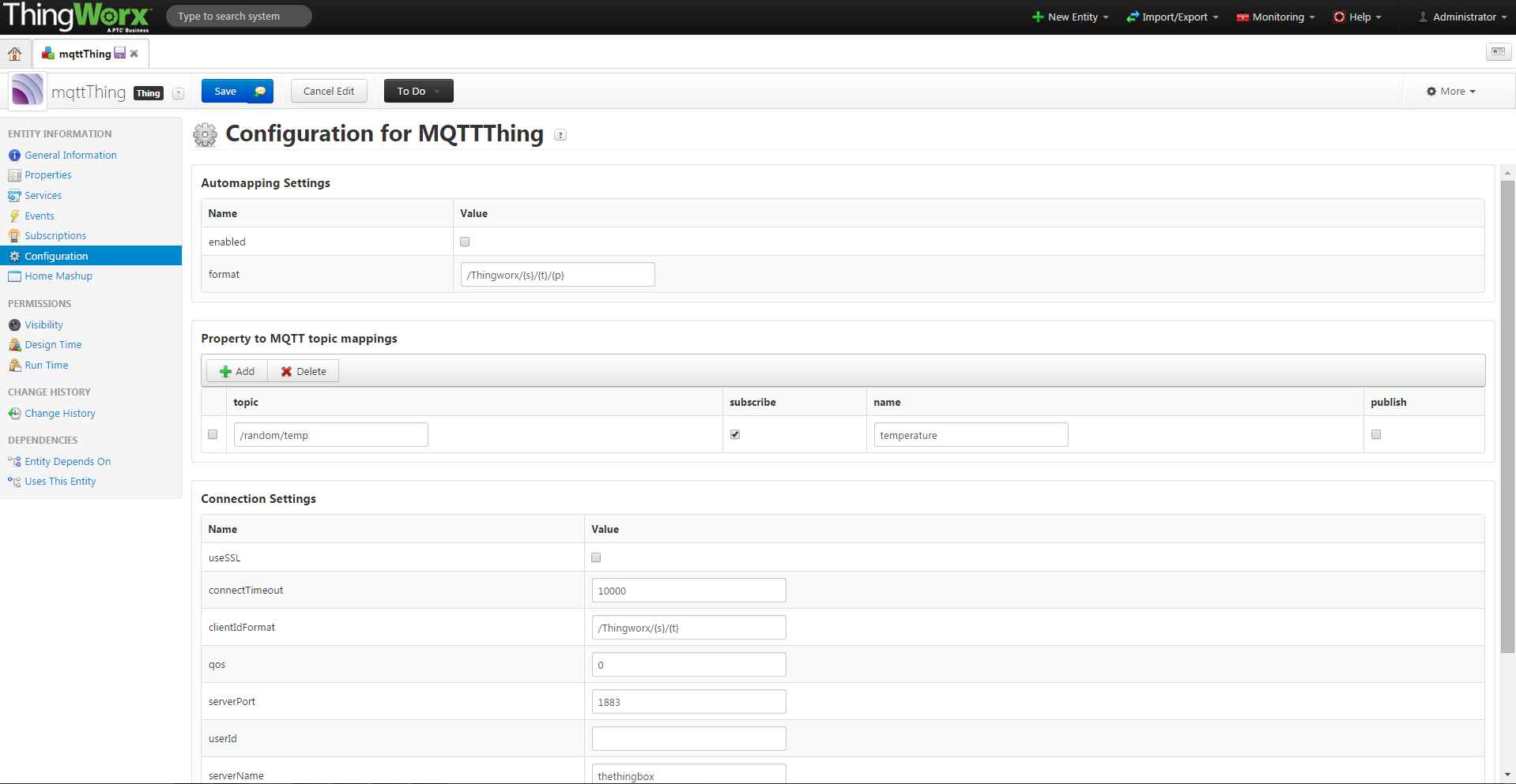

  • Auto mapping Settings on the Configuration page controls whether you want Thingworx to automatically generate topic name(s) based on a pattern that can include server name {s}, thing name {t} and property name {p} token(s)
  • Property to MQTT topic mapping paragraph allow you to map the topic (e.g. temp/random) with the property name (e.g. temperature) and publish and/or subscribe check box.
  • Connection Settings requires, at least, the serverName (e.g. test.mosquitto.org), the serverPort (e.g. 1883) and a qos (Quality of Service) value from 0 to 2:
    • 0: The broker/client will deliver the message once, with no confirmation.
    • 1: The broker/client will deliver the message at least once, with confirmation required.
    • 2: The broker/client will deliver the message exactly once by using a four step handshake.
  • Save your thing and test the connection by checking the isConnected service (value = true) on the Properties page - MQTT (ThingTemplate) - Properties paragraph
    (Note : I installed the Mosquitto client, subscribe to the topic and publish a message with value = 20)

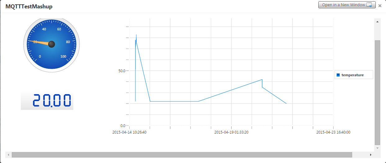

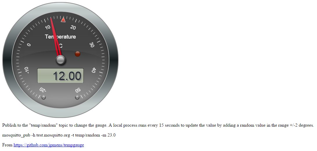

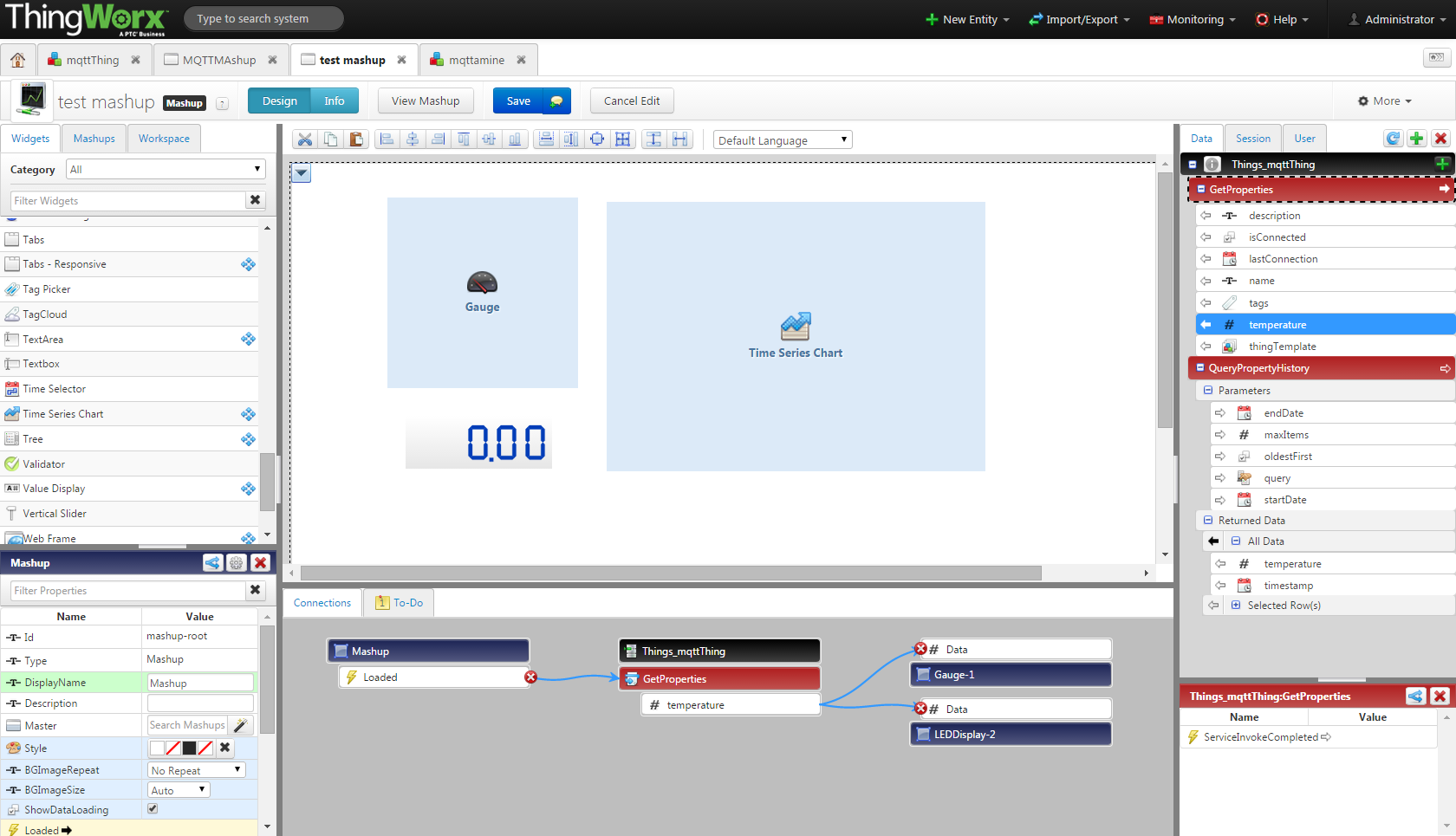

  • Once validated create a new mashup:
    • mashup type = Page and Layout Options = Static
    • add three widget: a gauge, a LED Display and a Time Series Chart
    • add an Entity by clicking on the Green Plus button on the upper right corner of the Entity area and choose the previously created thing.
    • add the GetProperties service, check the Mashup Loaded box, add the QueryPropertyHistory without checking the Mashup Loaded box and click Done button.
    • expand the GetProperties service and drag and drop your property (e.g. temperature) to both gauge and LED Display widgets (Select Binding Target = data)
    • expand the QueryPropertyHistory service and drag and drop the All Data parameter to the Time Series Chart widget (Select Binding Target = data)
    • save the mashup, give it a name and click on the View Mashup button.
Here’s the result:

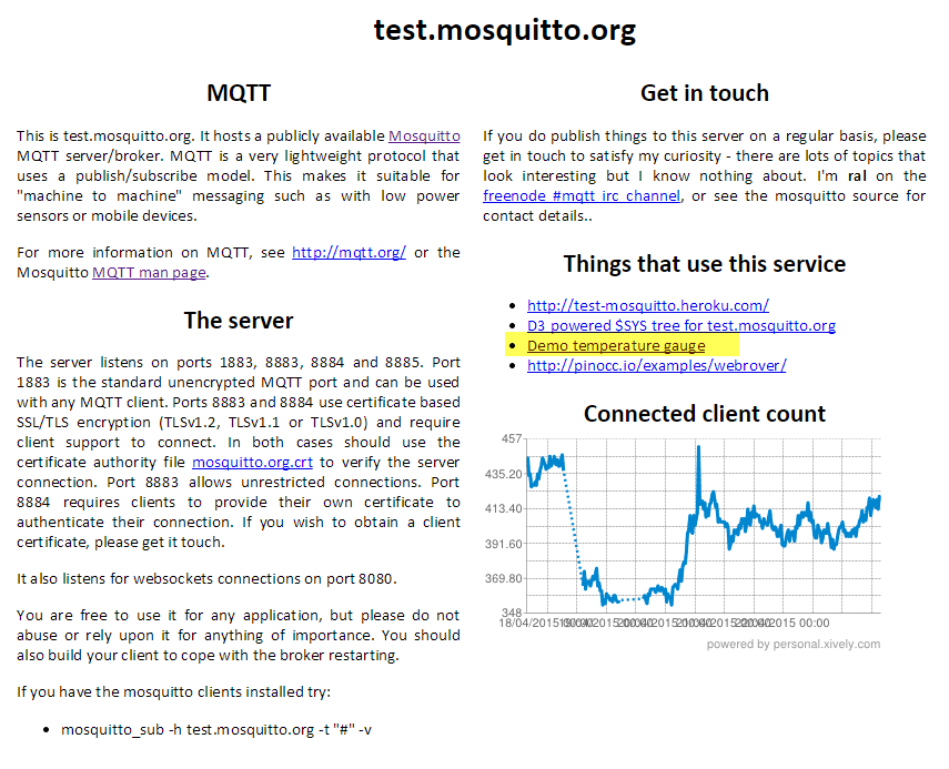

To test the extension without installing a MQTT broker please check the following website:
http://test.mosquitto.org/
