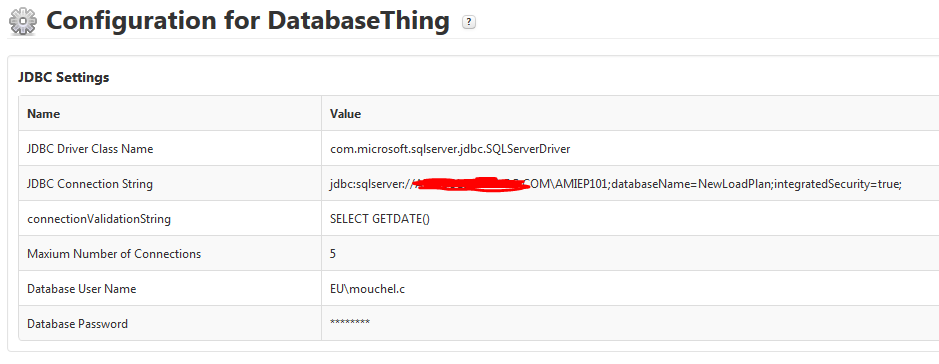

Here is the config I'm trying

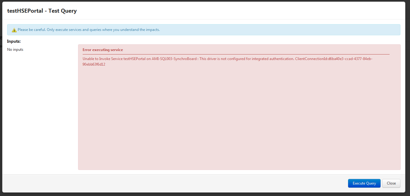

I'm getting this error when triggering a test service

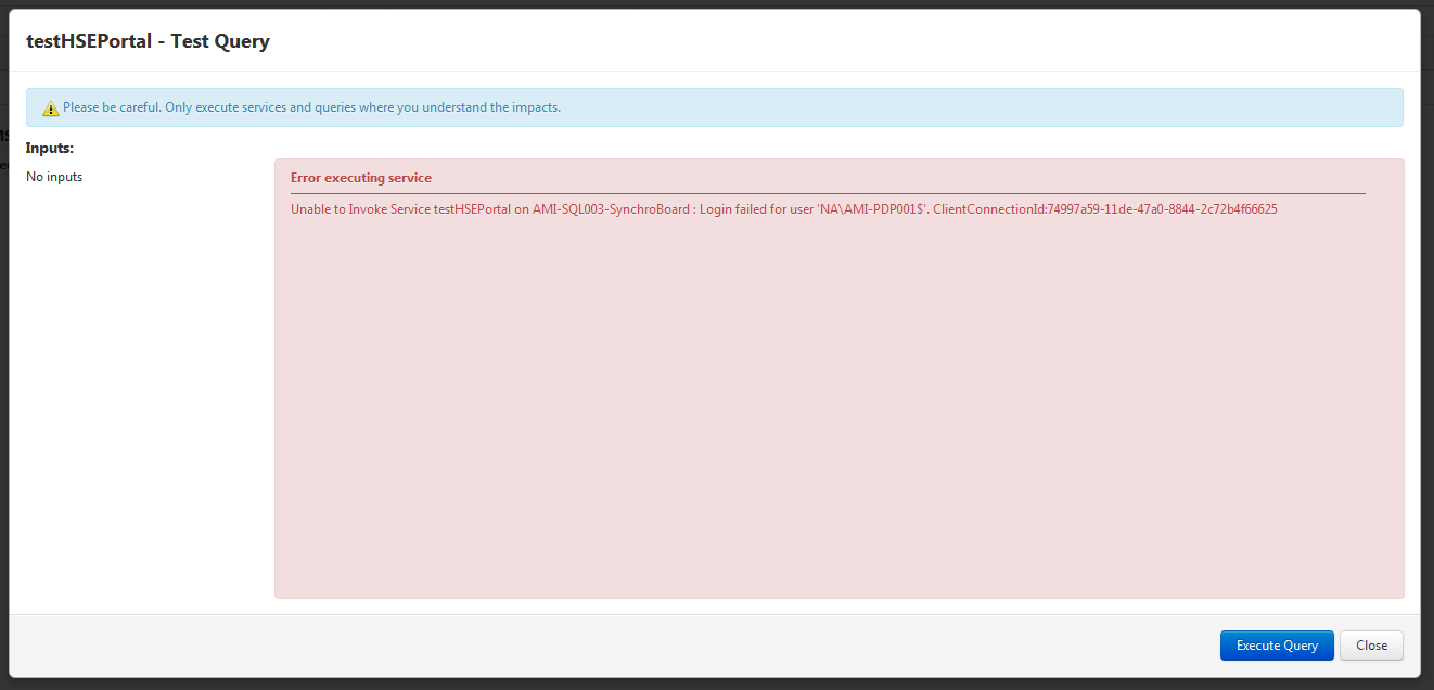

Following some advice on the Internet regarding the use of JDBC for Windows Authentication, I added the sqljdbc_auth.dll within my C:\Program Files\Java\jre1.8.0_77\bin directory.
Now I'm getting a different error. A login error.
What is really strange for me is that the service is not using the account I want to. The used username is actually the hostname of the server on which ThingWorx is installed...
Why the thing is not using my configuration?

Is there a specific reason you need to use a domain account for authorization?  I've tried a few things locally and I'm not certain the Microsoft SQL Server driver that the extension uses supports domain authentication using the DOMAIN\user format.
In other PTC products, I know they recommend using a SQL server username when setting up a database to avoid this sort of problem.

Reading over number of different posts on this topis it appears that Microsoft's jdbc driver doesn't support login from untrusted domain for example Connecting to SQL server in a different domain using jdbc driver
