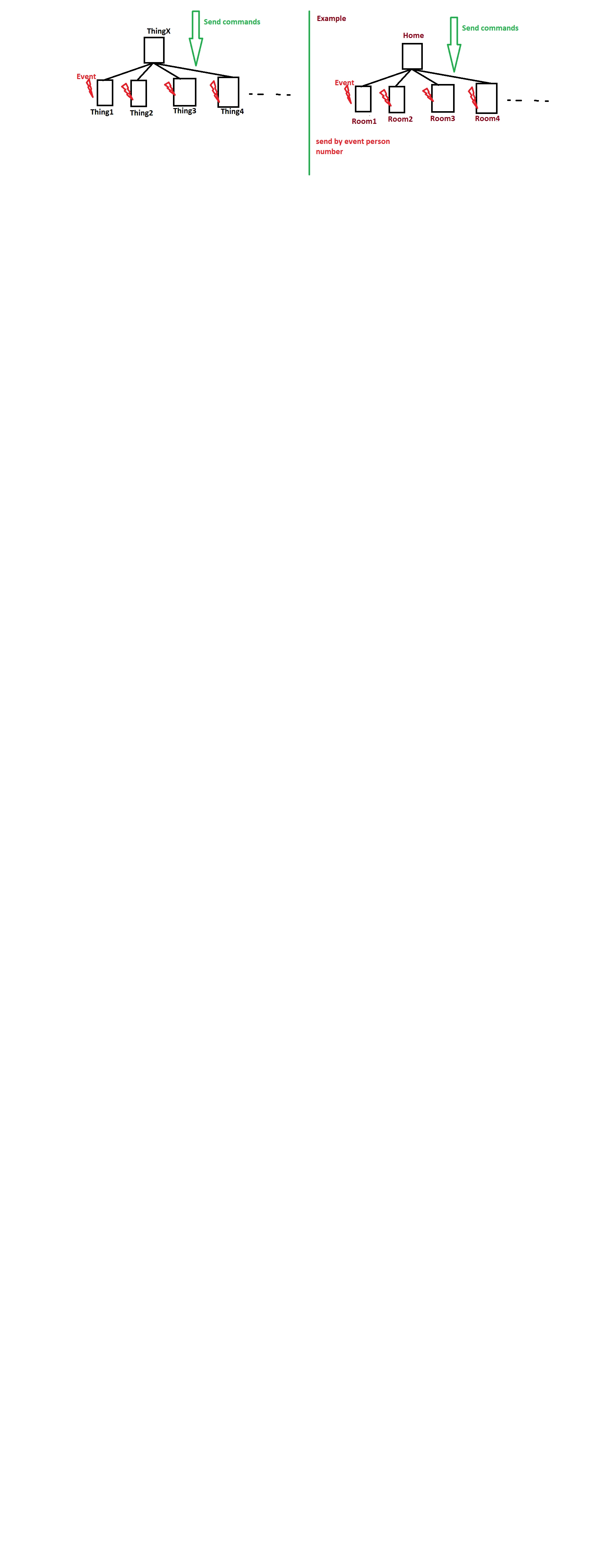

I have a thing template that implement a remote thing (csdk).
From the csdk i trigger an event. Then i subscribe to this event thingworx side.
In my case, i can have multiple remote things triggering this event simultaneously, and I want to subscribe to these events from another thing. I cannot find a way to do it.
Exemple
1 - Thing Template TT implementing the remote thing.
2- thing1, thing2,thing3,thing4 implementing TT and trigger 'event '
3- ThingX need to subscribe to the 'event' triggering simultaneously from thing1, thing2,thing3,thing4
Do you have an idea what is the best why to do it ?

Mar 29, 2024 4:42 AM UTC
Hi @AliBenBelgacem
You can create a subscription in Thing Template TT and call the ThingX service inside the subscription. So whenever thing1, thing2, ... thingN event triggered, service from ThingX will be triggered.
/VR
Mar 29, 2024 8:29 AM UTC
Thank you for your proposition but this what i already did.
I want to do it the opposite way. in my project the thingX contain thing1, thing2, thing3, thing4..
You can see the attached picture to understand better. I want that Home see and pilot room. the room work autonomously, no depending on anything. So in Room thing I should put no reference to Home.
Mar 29, 2024 8:57 AM UTC

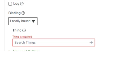

Hi @AliBenBelgacem
Could you please explain your use case.
Based on the diagram, you can locally bind property from ThingX to Thing1... ThingN in template level.
So when property gets changed in ThingX it also updates property in other Things. Based on that you can trigger your subscription.
/VR
