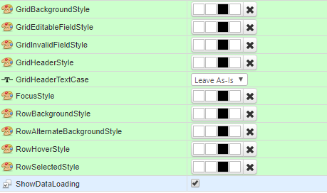

Dear Team,
I need to remove line color from grid.
I do n't want to show row line. How can we do?
    December 27, 2017
    Dear Bhuwaneshwar Gupta​,

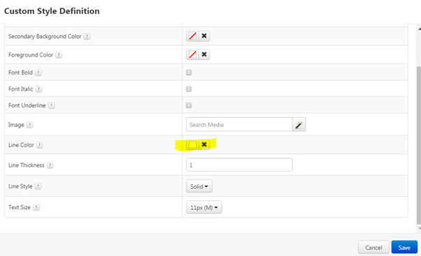

    You can use Grid Advanced Widget in your mashup and configure its properties as mentioned below to achieve the required.
    1) Select Grid Advanced Widget
    2) Customize its 'RowFormat' property

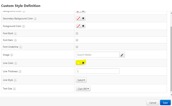

                 Make a new custom Style Definition for this property and Set Line Color to white as highlighted in below screenshot.
    3) Customize the 'RowAlternateBackgroundStyle' property
    4) Save and refresh the mashup. The grid on mashup will be like this
    Hope it helps
