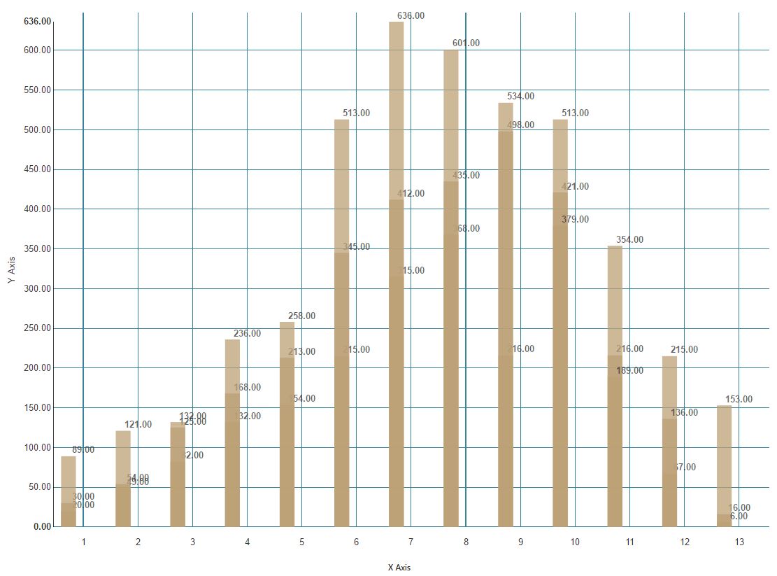

We have created a stacked bar chart with we need to show bar value at top of the bar in bar chart as shown in the figure. Let me know if that can be done in ThingWorx bar widget.
March 16, 2017
Not with the standard Stack Bar, but with the Marketplace Stack Bar you can. https://marketplace.thingworx.com/Items/Custom%20Chart%20Widgets
March 16, 2017
The Custom Chart Widget on MarketPlace doesn't have the option StackSeries as the classic Label Chart. The bars are shown one in front of / behind another, not as stacked bars. And the style of the first data serie is applied for all other serie (bug ?).
March 16, 2017
I don't use MarketPlace chart extension, I can't be on help, I know it has labels on bar chart but not much more, when we tested it we realized that wasn't much ready for production compared with the Standard one. I still don't know what TW did when they released this extension on the Marketplace, we need few of it's feature on the Standard ones but for the rest it's really less powerful than the standard one.
