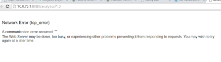

Hello everyone,
I have installed Docker community edition with version 17.06.2-ce-win27  on windows 10 desktop grade machine.
Then docker based analytics server with version 8.0   is installed on that.
after installing docker analytics server URL also generated.
http://10.0.75.1:8080/analytics/1.0.
after running URL,getting below error.
can any one help on that.

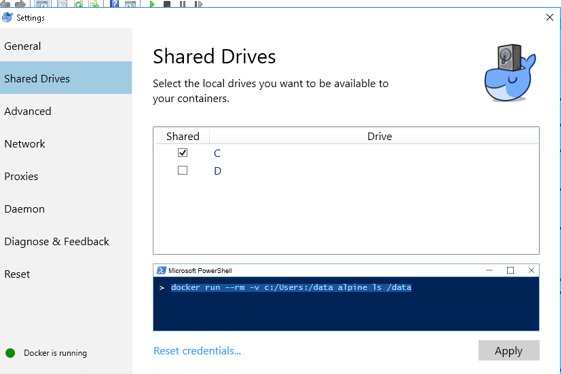

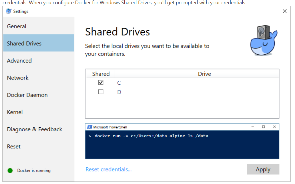

Could you please check in docker settings that your all the drives are shared or not. For windows 10 we use the native docker make sure you are using the same not docker toolbox. Please see the below screenshot for the same.
Please send me the result of these commands in docker terminal: 1) docker ps -a  2) docker logs analytics

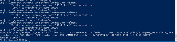

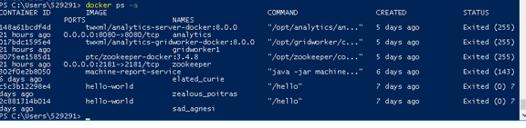

Hi Mohit,
Thanks for your response.
Please check below screenshots of commands.
docker ps -a

Hi Raji Vuta
Please check both c and d drive in the settings share drive option and follow the below article, hopefully it will help.
https://www.ptc.com/en/support/article?n=CS265097&posno=1&q=Error%20%22This%20page%20cannot%20be%20displayed%22%20is%20received%20when%20accessing%20about%2Fversioninfo%20API%20in%20ThingWorx%20Analytics%20Server%208.0&source=search
Do let me knoe in case of any question.
