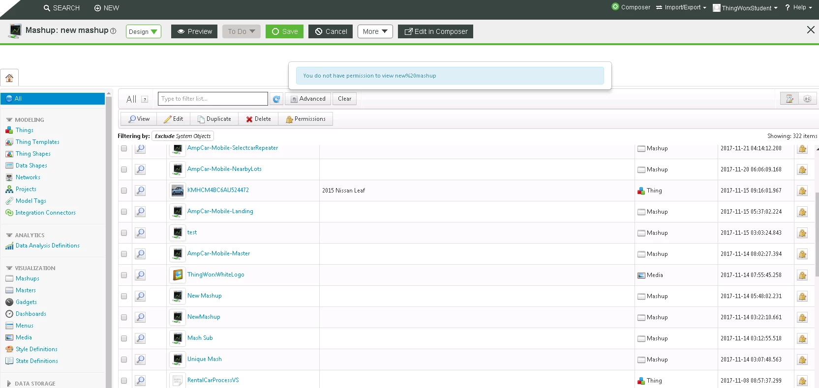

Hey Everyone,
I've come across something strange while working on ThingWorx 8.1, whenever I create a Mashup with the names including but not limited to "New Mashup" or "new mashup" and try and switch to it's Design mode after saving it. There are some other name samples too. It does these two things as follows:
1. It shows an error message stating "You do not have permission to view new%20mashup"
2. It opens up a view of the Classic Composer under the NextGen Composer
Which should not be the case when the UI has been switched to Next Gen Composer.

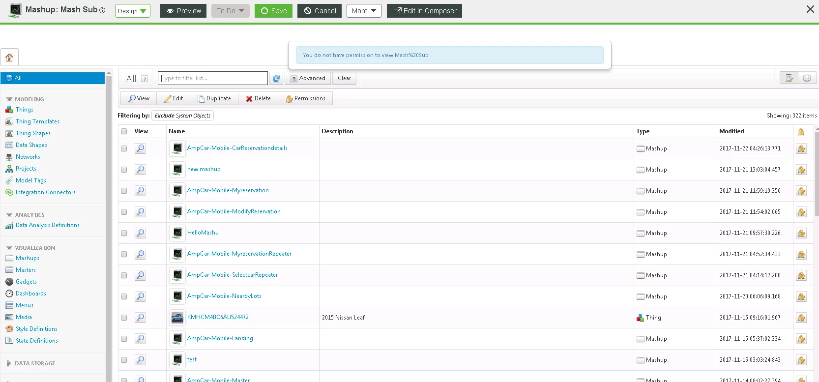

Also noticed another instance of the same problem when multiple mashups are selected and View button is Clicked, a view of the Classic Composer is visible.
NextGen Composer​, @ThingWorx8
Best answer by posipova
Reported as PSPT-4356. It does seem to be fixed in 8.1.1.

Thank you for letting us know; I will investigate and post an update to this thread.
20-Turquoise
November 29, 2017
I have confirmed the issue and will be filing a jira. Again, will update the thread with the jira number later.
posipova20-TurquoiseAnswer
20-Turquoise
November 29, 2017
