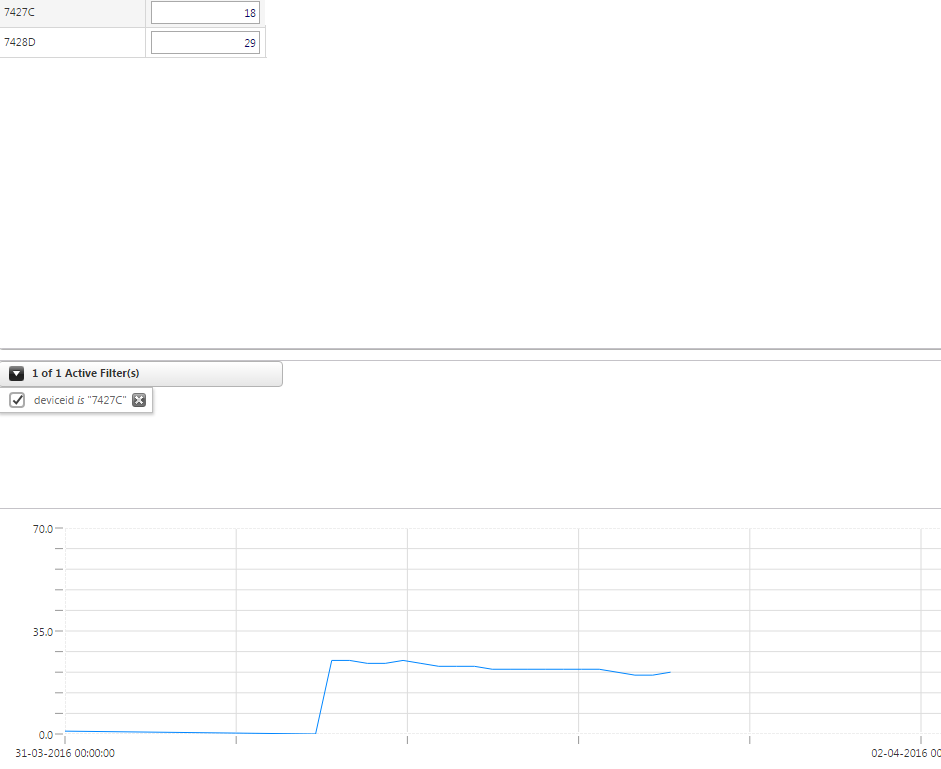

Hello everybody.
I am currently filtering a stream of data with the "data filter widget".
Here is my mashup.
The upper part presents the list of my sensors, given by the service "get data table entries" in a grid.
Below is the data filter widget where i need to enter the name of the sensor (device id) i am interested in (7427C in the example).
The curve is based on a stream, whose measures are selected thanks to the data filter (if i had written 7428D in my filter, i would have had a completely other curve based on that sensor).
That mashup is not very easy to use because i need to enter the name of the sensor to make the filter.
I want that the selection of a row in the upper grid gives the information of the selected devide (device id) automatically to a filter, to make it more easy to use. Is there a way to customize a filter just by clicking on a row ?
Thanks in advance for your help and your time.

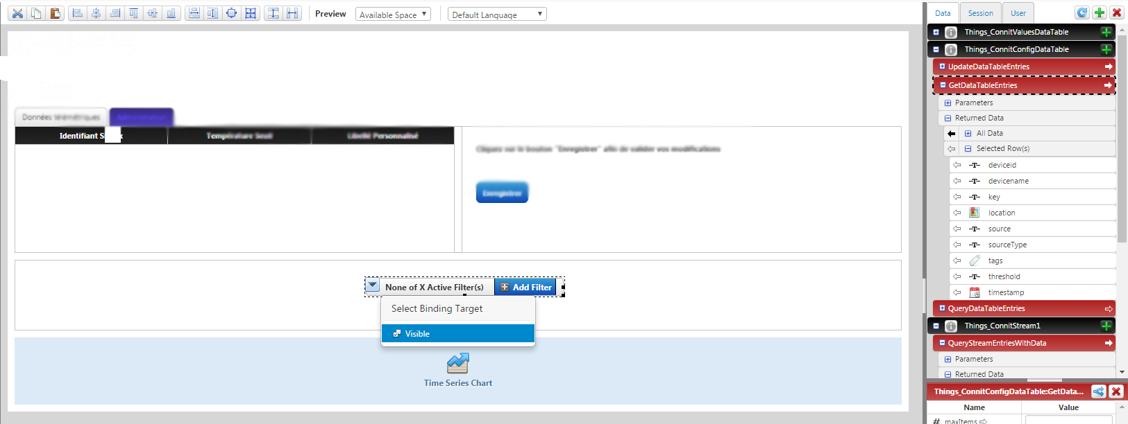

Actually, i cannot pass the "device id" that simply.
I am using a "get data table entries" service for a table. When i try to pass the parameter on the filter, i can only bind it to "visible" :
So i cannot use your solution.
Maybe i did not understand something about what to do ?
April 5, 2016
Hi, I think you can bind directly the "GetDataTableEntries / Returned Data / Selected Row(s) / [device id] or [device name]" to the parameter of the service binded to the chart, or to a service which takes the deviceid as parameter and returns the stream after filtering the data.

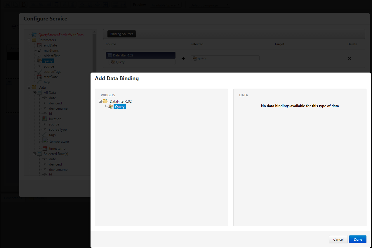

I cannot bind the device id to the service "query stream entries with data". I don't know why but no data binding except the one linked to the data filter is listed. And for the data filter, i am forced to type the name of the device each time i open the mashup.
When you recommend using a service that takes device id as a parameter, do you have one specific in mind ? I could not find any that can address my problem.

QueryStreamEntriesWithData has a parameter called Source - bind directly to the parameter.
