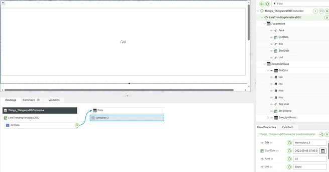

Parent Mashup:
Collection widget:
Mashup -> set to Child mashup
MashupPropertyBinding:
"cva": "cva",

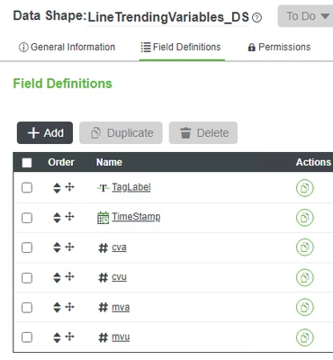

Data Service: (Data Properties populated with values)

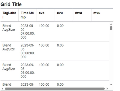

I was able to verify that the service is being processed and delivering data by placing a Grid widget in the Mashup to collect the data.  This was successful so I know there is data coming in:

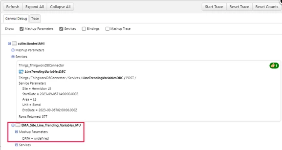

Debug Info:
Here I can see that the system is showing DATA (The mashup parameter shown above in the Child mashup) as undefined.
NOTE:  I'm pretty sure the issue has to do with the MashupPropertyBinding formatting or content but I don't know what that issue might be.

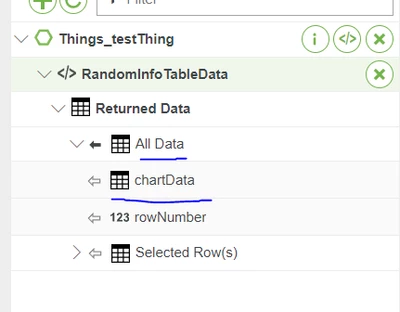

If you want to pass InfoTable value to the collection child mashup, your service should return the data as a Child InfoTable. Something like this
Collection MashupPropertyBinding should look like this
Output :
