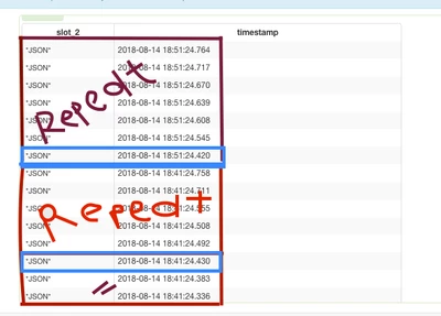

I have 8 JSON properties on a Thing and each of them representing a big cable of temperature sensors and each 8 of them stores 24 temperature readings.
Now when I want to query those properties, I see bunch of duplicate rows with different timestamps.
When I looked closer to it, I realized that duplicate rows are because those 8 cables updating themselves in random order, and each time when a cable updates itself, the other cables also getting a time stamp and that causes abnormalities when I QueryNamedPropertyHistory.
I dont know what s the optimum solution for querying the history of a JSON parameter, but I need urgent help about this.

Depending on the answers to the above questions you might want to consider adding some abstraction to your data model. It sounds like you have 1 Thing with 8 properties, and each properties has 24 temperature readings embedded in JSON. Consider making a CableTemplate that has a rawJSON property that gets parsed into 24 temperature reading properties every time rawJSON is updated. Once you have the CableTemplate you can create 8 Things that represent the cables: cable1, cable2, cable3, etc.

1. It s a generic Thing, and I use ThingWorx 7.2.6-b76
2. JSON is getting updated via a Service I wrote, in that service I use update property values, I dont do anything different than what I have been doing for other device types, except for the fact that I use JSON property this time, rather than number,string etc.
Since I wrote the whole front-end application to support this structure, I really dont want to make significant data store type change. However if I have to, I have to.
But I believe it should be something simple, why does other json properties gets extra TimeStamp value when I dont update them? that s the question that I am trying to find its answer.

I can not duplicate the issue you are seeing.
I created a GenericThing, assigned a ValueStream, and added three JSON properties that are logged. I created 3 different services to set a random value for each of the properties and exercised the services to set properties two and three with the 'Test' button in Composer. When I run the QueryNamedPropertyHistory with the Test button I get the results I expect, no changes to property one.
I would look into the service you wrote to be sure it isn't updating all the property values. The timestamps are 50-80 milliseconds apart which seems about right for being triggered by an outside service and not internal.
