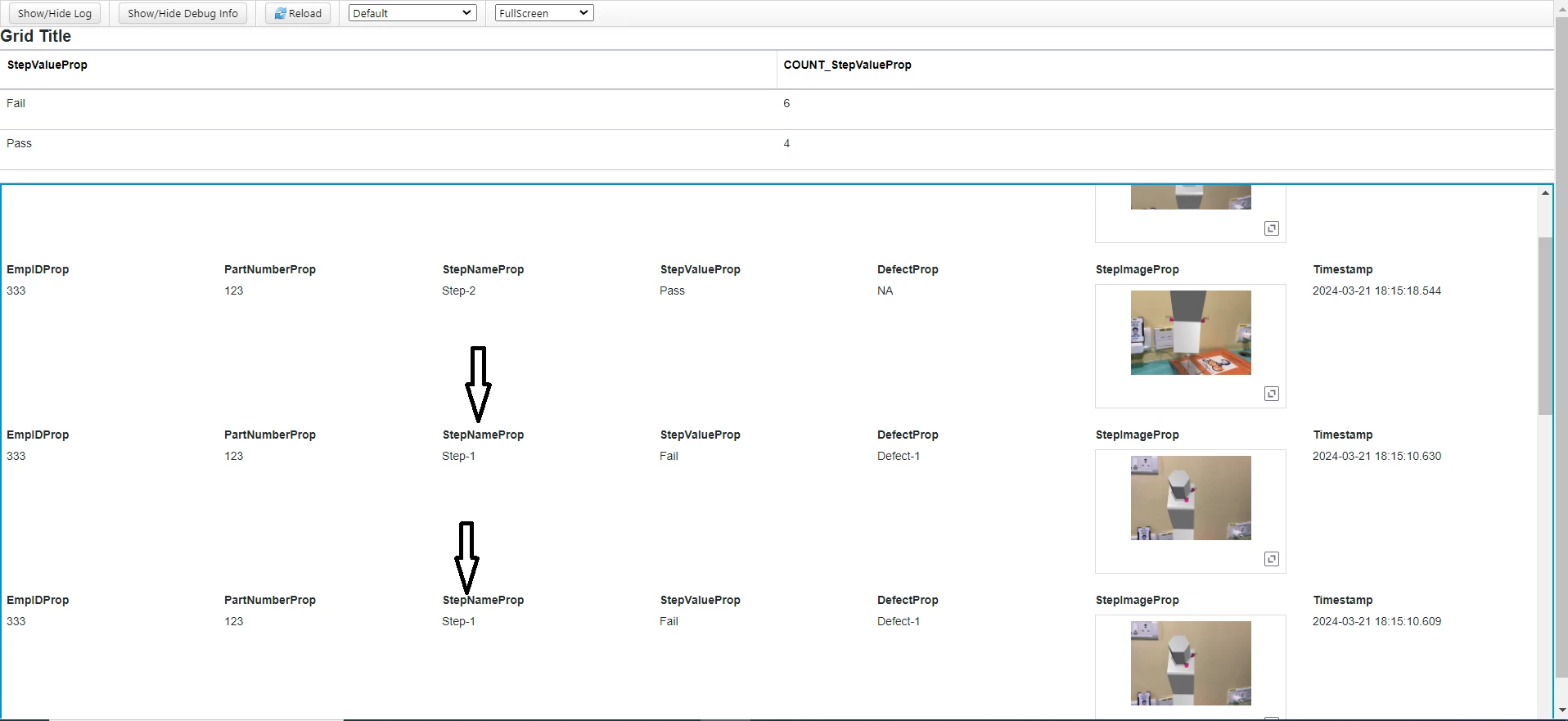

I am facing problem in logging properties there are some values which are repeating after I carry out the experience multiple times.
PFA attached image in which arrows are shown on the readings which are repeating when I consume the AR experience on my Ipad on view app for multiple times.
I just want to log the properties which are entered by the user on vuforia view app.
Below is the code I am using to write properties from Vuforia Studio to Thingworx:
I have written 2 services for pass & fail
Vuforia Studio JS Code:

VelkumarAnswer
Mar 28, 2024 7:57 AM UTC
Hi @Aditya1702
Instead of logging data into the ValueStream. You can use Stream or DataTable (if it is low-frequency data) to store data in Thingworx which will avoid multiple entries.
Please refer here for DataTable services -Data Table Services (ptc.com)
About stream -Streams (ptc.com)

My purpose is I want to enter records row by row into an infotable.
eg, I have these field definitions in datashape: ID, Name, Status, TimeStamp - I want to enter records for these columns,
Record1: 1, Name1, Pass, 27/03/2024
Record2: 2, Name2, Fail, 27/03/2024
Record3: 3, Name3, Pass, 27/03/2024
Thanks in Advance.

Hello Everyone,
@H_1234 , @Velkumar , @Rocko , @
Thank you for your support. I am using Datatable instead of Streams to store records into ThingWorx. Its working properly at present.
