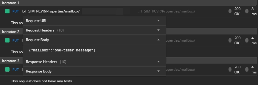

Follow the PTC University course Fundamentals of IoT Development with Whingworx M7.7 Getting Starged with REST. I created another request in POSTMAN which would PUT single value to the Thinwgorx Thing flawlessly.

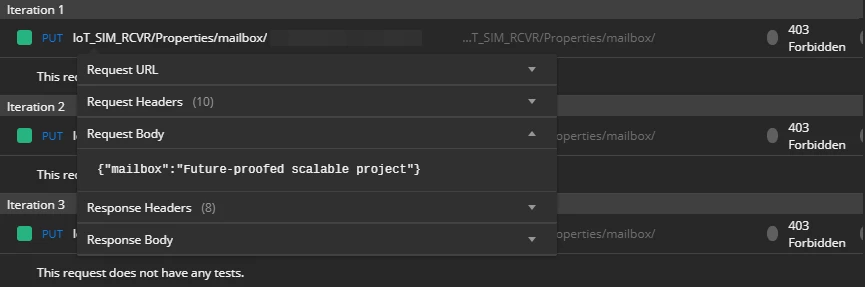

As I tried to use the Collection Run to PUT a series of values. I got 403 error.

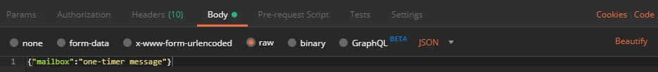

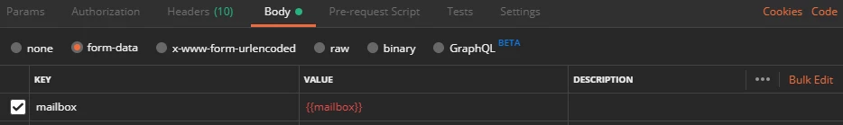

The only thing I changed is the Request Body, but I see no difference in the log.
Both are {"mailbox": "some-string"}

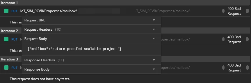

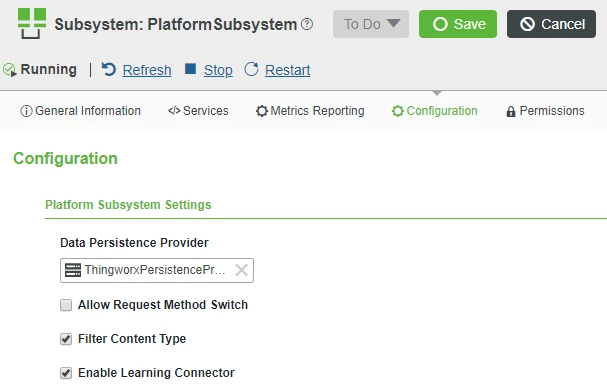

I tried solution the in REST API test of simple service returns HTTP 403.
go to System / Subsystems / PlatformSubsystem / Configuration. Check "Allow Request Method Switch" and uncheck "Filter Content-Type"
And it lead me to error 400.

Best answer by dsgnrClarK
I checked the subsystem configuration, same as yours.
Nevertheless,  after accidentally system reboot. POSTMAN Collection Run works out flawlessly.
