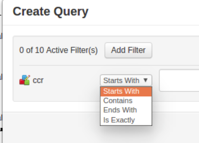

I have such thingShape:
report: TEXT
internalThing(ccr): Thing Name
I would like to Query all implemented things that doesn't have internalThing.
I tried QueryAllImplementedThings service of my Template
I don't see any negative predicates.
22-Sapphire I
April 30, 2016
You may need to use a custom Service
if you look at the Query parameters available: Query Parameter for Query Services
There is NE, NOTLIKE, NOTIN

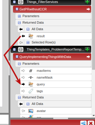

I created service GetPRwithoutCCR ​with corresponding code inside:
var query = {
    filters: {
        type: "EQ",
        fieldName: "name", value: "AAA"
result = query;
But I am proceeding get all implemented things without applying filter. What am I doing wrong?
May 3, 2016
Are you invoking the QueryImplementingThingsWithData after your Query service runs ? If not then QueryImplementingThingsWithData service may be running with an empty input query as it is being triggered before or at the same time as your query service...  check if invoking it after solves your problem !!
For brevity I think its always good  practice to follow what Pai suggested in a prior reply.
