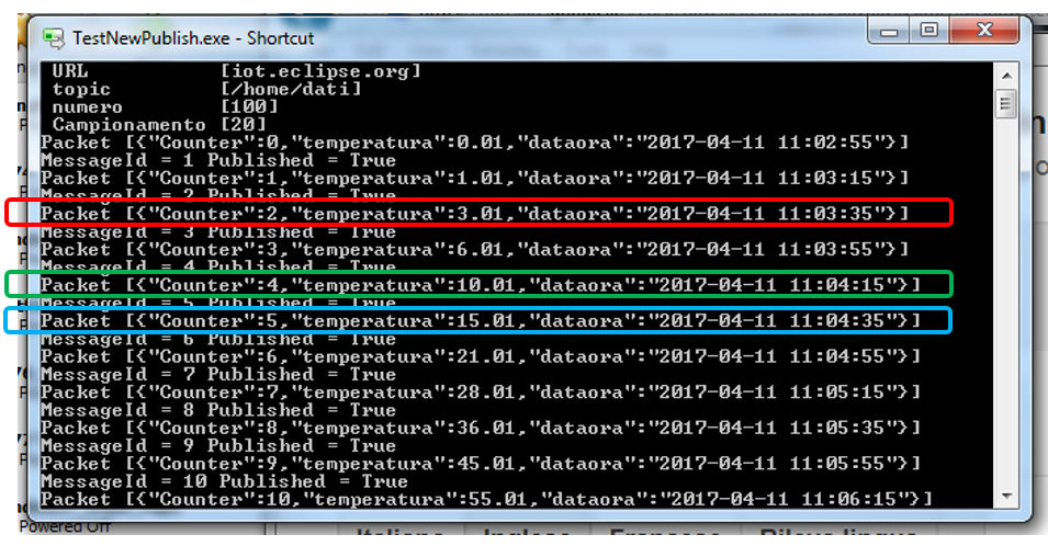

I use Thingworx with extension to get information from broker mqtt.
I sent a json packet to broker Mqtt like that
any packet was sent every 20 seconds.

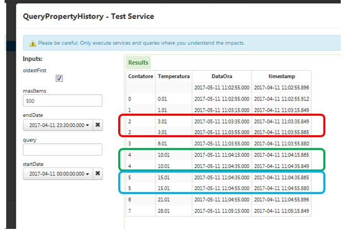

If I look the information stored into value stream I found more rows of those that I sent
after 8  json data (counter from 0 to 7)  sent to broker ->Thingworx I found 11 rows in value stream.
Why that ?
how I can avoid this ?
Many Thanks

Hi Dimitri Bologna​,
Are you Subscribing and Publishing in the same MQTT Thing?
Which ThingTemplate from the Extension are you using?
April 11, 2017
Hi Ankit,
I used two different Thing :
1) the first implement the Thing Template MQTT (extension)
2) the second implement a Thing Template that was customization  from Mqtt thing template
For both sample there is the same issue.
For both example I use only the Subscription.
My configuration is:
- windows 7 64bit
- thingworx 7.2.3-b48
- presistent provide H2
- java jre 1.8
- tomcat 8.0.36
Many Thanks
