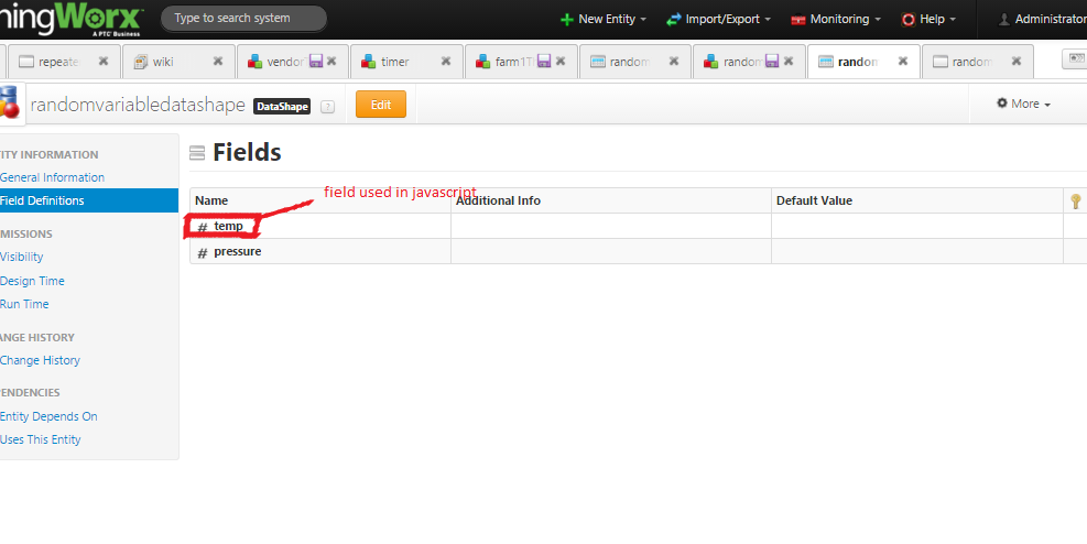

What is Data Shape ?
A DataShape is a specification of the required property names and return types each property of a JavaScript “Object” must have to be added to an InfoTable.
DataShapes also contain other metadata about a property that is useful for formatting and displaying the InfoTable in a tabular format or Grid.

row.temp is already  defined in the datashape.it will updates the value in the datashape,whenever the service executes.

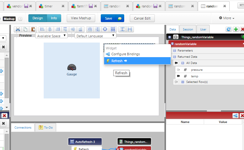

Mashup:

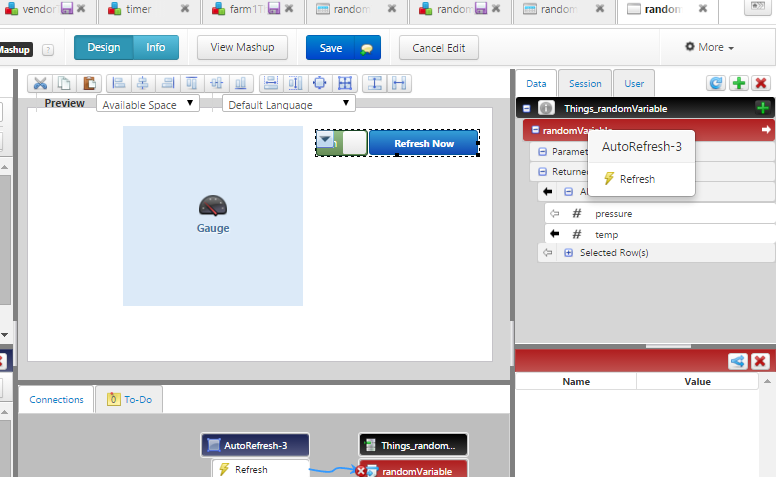

in mashup use gauge to display the random value.
1) select the service(already created random service)
2) drag the data to the gauge
3) In widget, drag the auto refresh set interval as your required.
4)click the refresh configuration, select refresh and drag to the service.
5) then click the view mashup.
