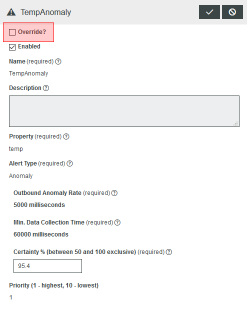

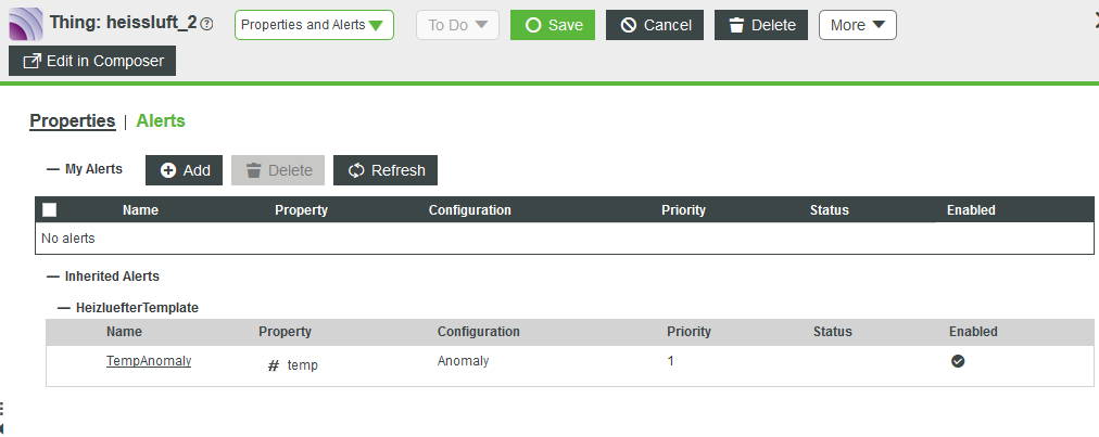

I have some things which based on a template. On one values of the templates I add a alert of type anomaly with the new composer. Since I add this alert I get this warning for every thing where I change the property:
"Received Value for ThingWatcher [THINGNAME-PROPERTYNAME-ALERTNAME] but ThingWatcher does not exist."
I thing this had something todo with the fact that the alert is bind with the template and not with the thing itself.
I can say that the thing have to override the alert:
This copy the alert into the thing and the warning it not longer displayed. Additionally the status of the alert is switching from nothing to "Initialized". But this is a stupid way if you had many things.
It's there any other solution?
