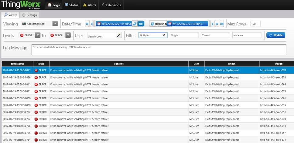

Hello ThingWorx Community!
I started receiving this error message "Error occurred while validating HTTP header: referrer" and I haven't been able to find much online in regards to what could be causing this error or the possible solutions to correct it.
Any information or guidance pertaining to what causes this error message and how I should go about fixing it would be greatly appreciated!
Thank you!

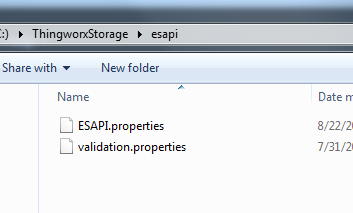

    What is your ThingWorx version? You may  try stopping tomcat, then removing these two files and starting the tomcat again:
    20-Turquoise
    September 27, 2017
    And as a quick follow-up, it may also refer to this problem:
    https://www.ptc.com/en/support/article?n=CS235101
