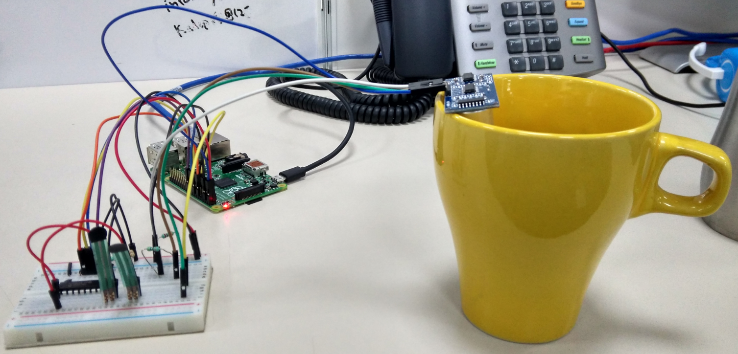

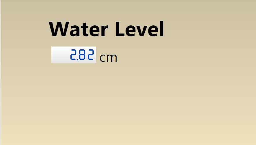

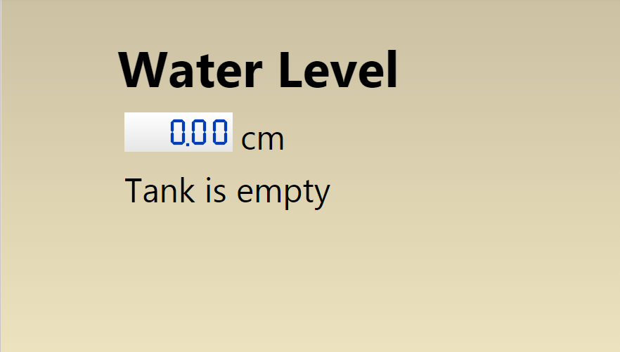

    Hi Joseph,
    I have a small prototype ready for Water Level Sensor. This is developed with Ultrasonic Range Finder Module Sensor and Raspberry Pi. Here are some images I have while developing it. I have integrated output of that sensor with ThingWorx and created a small mashup to display its value.
    Here are some best suited options:
    1) Ultrasonic Range Finder Module Sensor and Raspberry Pi:
    Cost: $45 max.
    If we have a good internet connectivity, then this is a good option and we can integrate some more sensors for other purpose with Raspberry Pi. Instead of using ThingWorx (as there is a licensing cost associated with it) we can directly program it on Raspberry Pi. There are Javamail libraries available through which we can send sms and emails.
    Here are some links from amazon:
    Ultrasonic Range Finder Module Sensor,
    Amazon.com: DROK®Accurate Arduino Ultrasonic Distance Meassuring Sensor Module Precise ULtrsound Wave Distance Measureme…
    Raspberry Pi,
    Amazon.com: Raspberry Pi 2 Model B Project Board - 1GB RAM - 900 MHz Quad-Core CPU: Computers & Accessories
    2) Ultrasonic Range Finder Module Sensor and Arduino Uno R3:
    Cost: $53
    This is an alternate option for Raspberry Pi.
    Arduino Uno R3
    Amazon.com: MakerBest Hight Quality Compatible Arduino UNO R3 ATmega328P Development Kits: Computers & Accessories
    GSM Shield for Arduino:
    Amazon.com: GSM GPRS Shield for Arduino: Computers & Accessories
    Please let us know your ideas and if you have shortlisted any and feedback as well.
