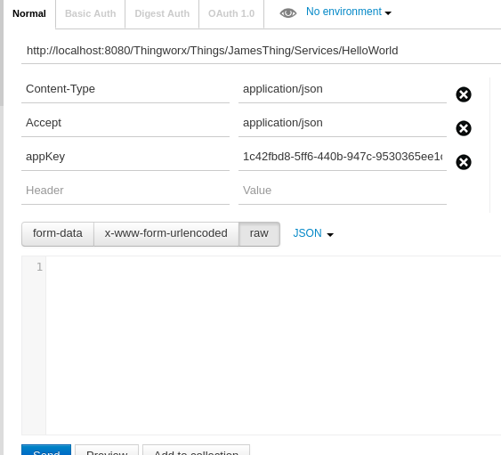

Dec 21, 2017 6:11 PM UTC
Hi Murat,
From a security standpoint, its preferable to use http headers over URL parameters.  For example
Post to http://localhost:8080/Thingworx/Things/JamesTestThing/Services/HelloWorld
Headers:
Content-Type: application/json
Accept: Application/json
appKey: <someAppKeyAsAVeryLongString>
This returns a result for me

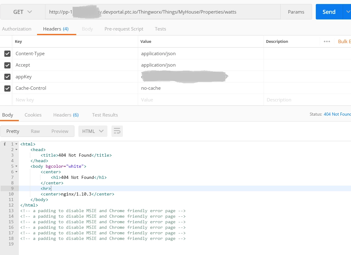

Mar 9, 2018 5:39 AM UTC
I tried your suggestions and is making a GET call to a thing property from Postman.
I have tried sending the appKey in url and it gave me a 404 not found error.
Next, i tried sending it as Header and still I am getting a 404. please see the screen shot attached. Any help would be appreciated.
