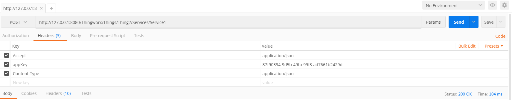

When calling a ThingWorx native service such as Thingworx/Users/[UserName]/Services/GetOrganizations, the following error is returned: "HTTP 500 - Content type may not be null".
The error is logged in the "Security log", with Origin : S.c.t.s.a.AuthenticationFilter
We use ThingWorx V6.6.0 with a standard install and the test is performed with either Postman or curl.
Any help to fix this issue would be welcome.
Thank you.
Stephane
March 30, 2017
I have the same error when calling one of my custom services using Postman REST calls:
http://MYDEVELOPMENTENVIRONMENT/Thingworx/Things/MYTHING/Services/MYSERVICE?appKey=MYAPPKEY&x-thingworx-session=true
Any progress?
April 7, 2017
Hi Stephane & Tim,
Content-Type cannot be null in ThingWorx. It tells the server what kind of result to resqponse to the client. If it's null, server cannot decide which type of result to return to the client.
So in Stephan's use case the URL should be Thingworx/Users/[UserName]/Services/GetOrganizations?method=GET&appKey=...&Content-Type=application/json
And Tim's use case is http://MYDEVELOPMENTENVIRONMENT/Thingworx/Things/MYTHING/Services/MYSERVICE?appKey=MYAPPKEY&x-thingworx-session=true&Content-Type=application/json
Below screenshot is my test result.
Lily
