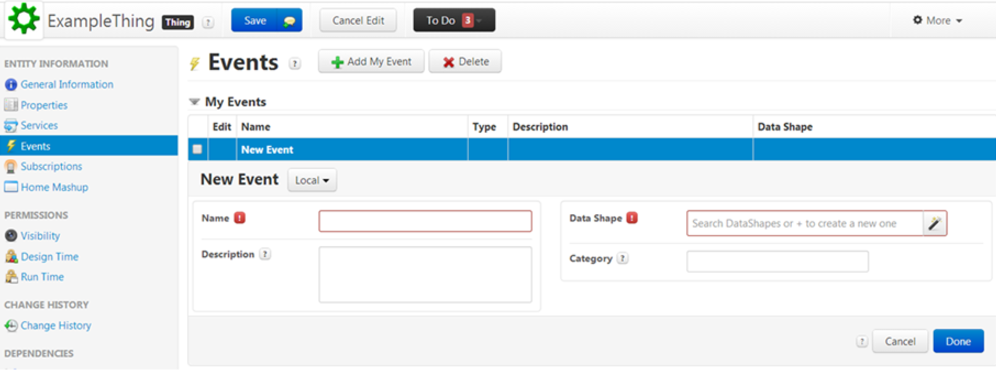

Hi Johan Bester, Could you please confirm the way you have followed to create an event for the thing ?
Did you create a custom event on the thing as shown below?
or Defined the events at the thing, thing template or thing shape level?

Neither. I was expecting the built-in data change occurrence when a value is changed to happen. It does fire and log the value to the value stream to be found under QueryPropertyHistory when I change it manually in the system, but when the property value is updated using the REST API it changes the value but does not get stored in the value stream.
