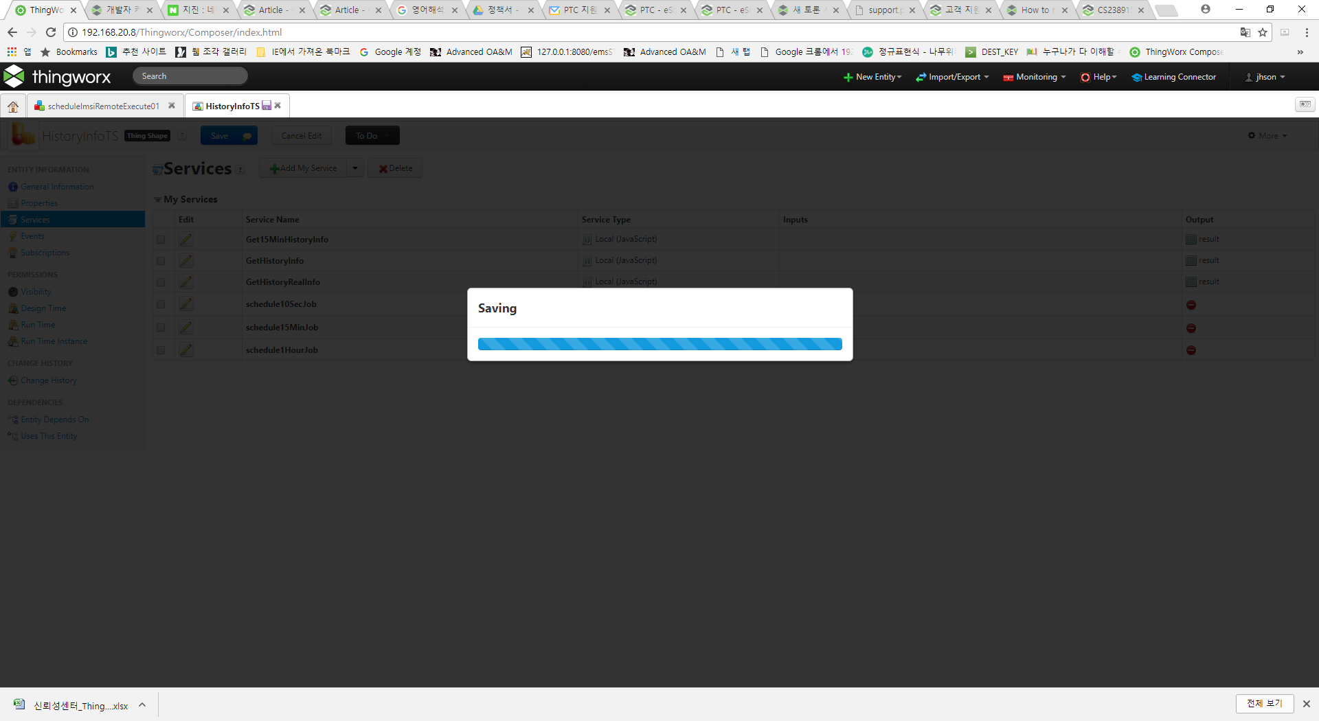

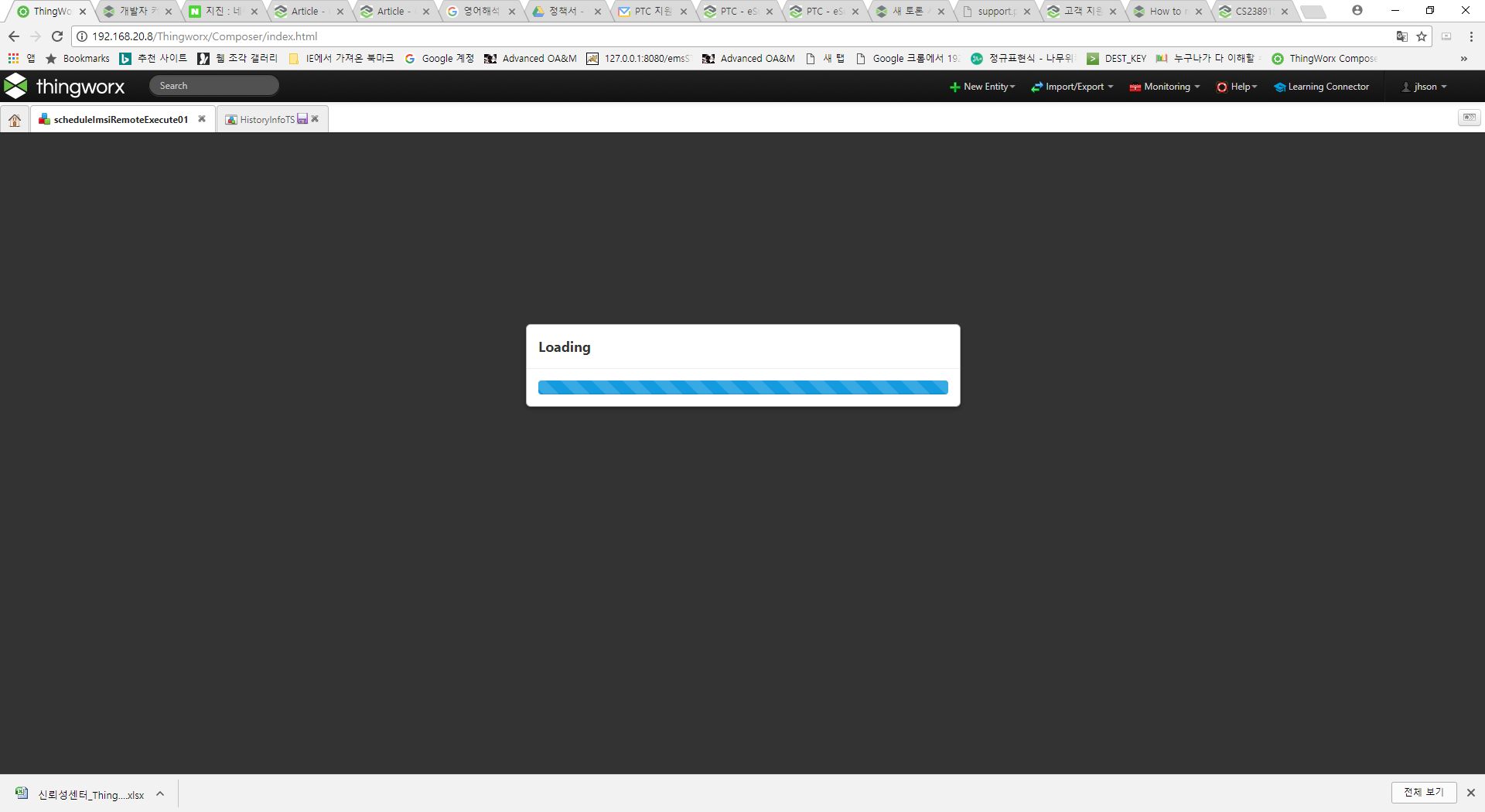

Is there a way to clear the cache on the server? Restarting the server seems to bring the last strange information
And Thing or Thingshape that brings that strange information is not stored.
November 15, 2017
Hi Junghun, to clear the cache from tomcat you can stop tomcat and then navigate to \\<TomcatInstallation>\work\Catalina\localhost\ and remove or back up the Thingworx folder to different location and restart tomcat server. This should clear up the working directory in Tomcat for ThingWorx.
