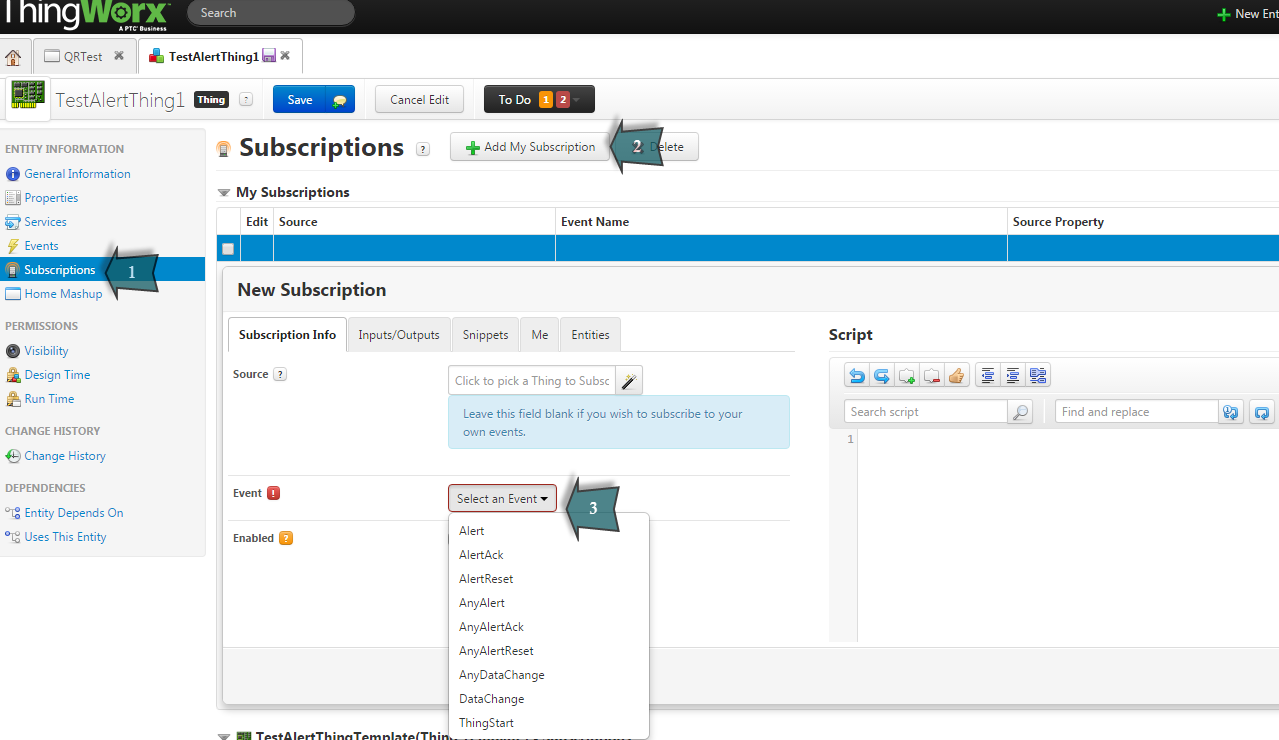

    Hi Velkumar, here's what you need :
    Navigate to ThingTemplate/Thing for which you want to create subscription
    1. Click on Subscriptions under Entity Information in the left panel
    2. Click Add My Subscription
    3. Select the Event as you can see in the screenshot below like for .e.g DataChange
    4. Once you select the DataChange you'll be asked for the Property on which the DataChange event must fire
    5. Finally, in the script section over the right you can either write your script or can call an already existing service
    Hope this helps.
