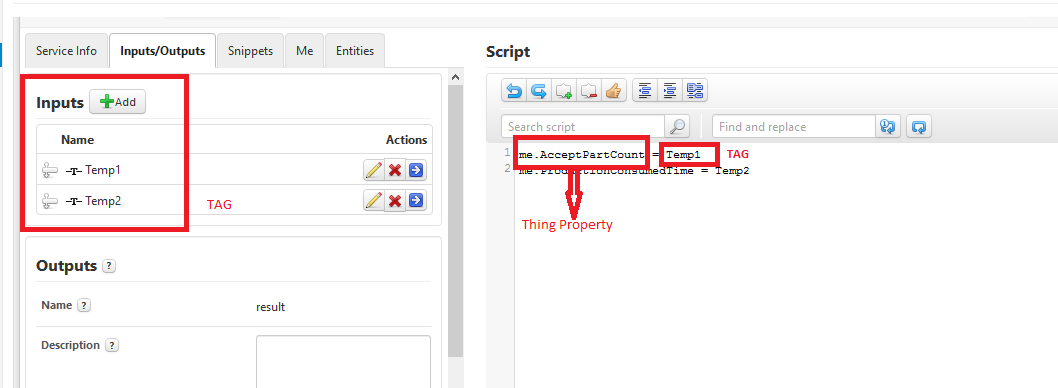

All is clear except attaching Thing name as mentioned in your Example: {"Temp1":"23","Temp2":"24"}
if i have two Things and need to update their values top platform, how can i attach them with your mentioned flow
May 15, 2017
Hi Mohamed,
{"Temp1":"23","Temp2":"24"}  ​is Tag and its Data. Tag must be identical to inputs of service.
If you need to update two things you need to change "Thing Name" in URL
www.yourdomain.com/Thingworx/Things/<ThingName>/Services/<ServiceName>?appKey=XXXXXXXXXX\
