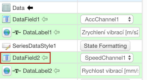

Hi there,
I have rather simple request, I would like to show/hide dataFileds on Bargraph based on button or list or radiobutton (does not really matter).
This is a basic functionality at almost every JS Graph library. I cannot replicate this behavior though.
There is no bindable DataFieldxVisible boolean which I could use.
I could assign the Name to the dataFieldx directly, but I dont know what is its data type.
Any suggestions??
