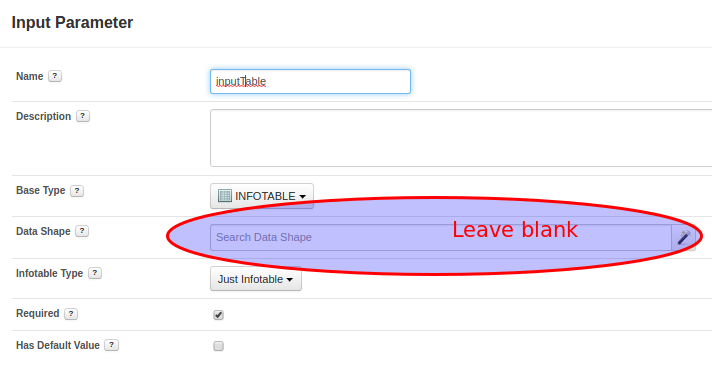

I would like to set the visibility of some of my widgets according to the number of rows in an infotable that is returned from a service. So, for example, if the resulting infotable had 0 rows I might like to hide a button.
Is it possible to write a generic service that would take the result (infotable) of one service as the input parameter of a second service, without needing to know the datashape associated with the infotable of the first service and return the number of rows. Or is there a better way to determine the number of rows in a result?

Hi, thanks for the reply.
I don't have any additional computation to do, and as you say, I intended to use .getRowCount() in my second service, but wasn't sure if I could pass an infotable to the second service without knowing its datashape. So I might have 2 services that return infotables based on 2 different shapes
1. result1 = MyGetImplementingThings() ;
2. result2 = MyQueryAlerts() ;
each of the above will return an infotable, but they will be based on different datashapes. I'd like to pass the results of both into a generic service that would return me the number of rows. e.g.
var count1 = GetNumRows(result1);
car count2 = GetNumRows(result2);
Is that possible?

Finally got around to testing this and it is possible to write a generic service to return the number of rows in a returned infotable, regardless of the datashape of the infotable.
It is as simple as not selecting any datashape for the input. The service can then contain a simple 1 line of code...
result = inputTable.rows.length ;
seems to work okay.
