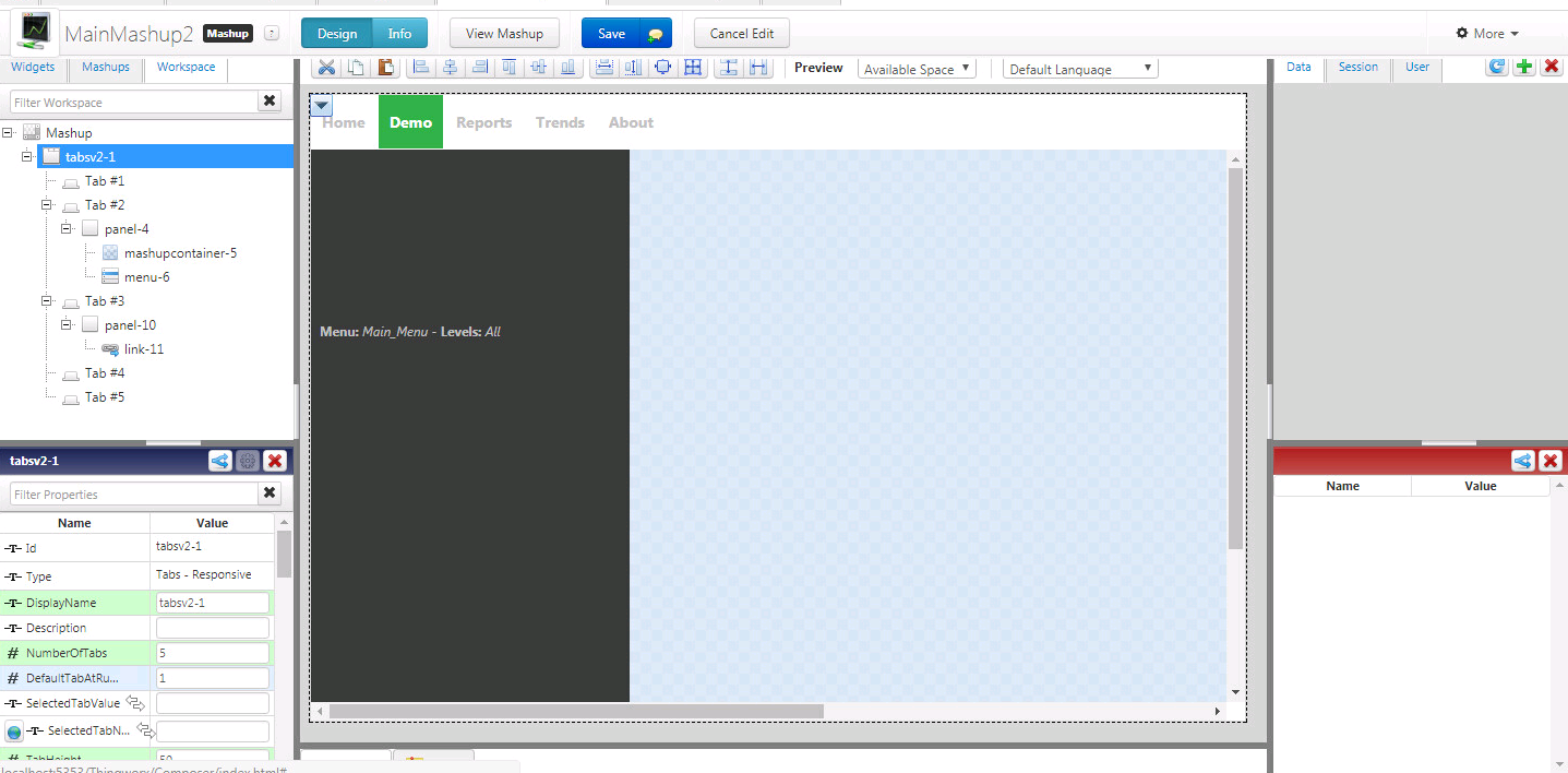

I have a  main mashup with a tab widget and a mashup container inside the second tab. This mashup container calls a mashup that contains a menu widget.
What happens is: I cannot see the menu widget in the main mashup unless:
  • Set this tab (Demo) as lt tab Default tab at runtime
  • Use vertical view instead of horizontal
I don't want either of these options. What am I missing?

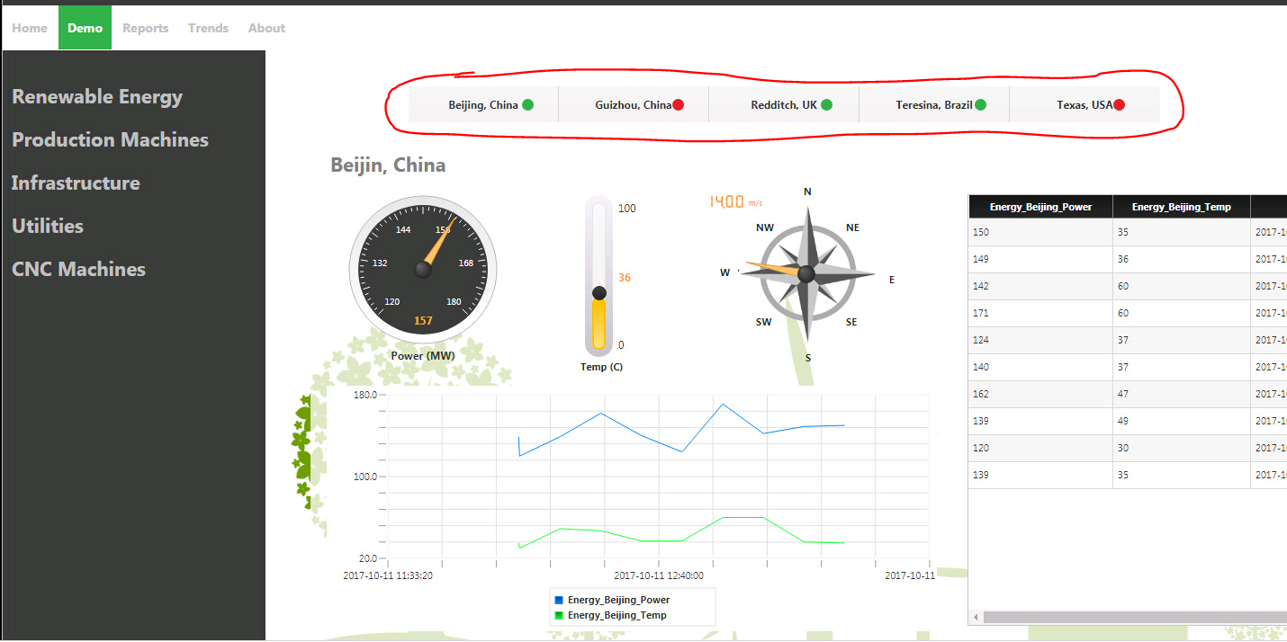

This is what I should get:
This is what I am getting:
Thanks in advance.

Are you in chrome? If you click f12, you may look into the dev tools. Try navigating/hovering over the area where the disappeared tabs are and  see if there is anything unusual with the styling.
iherreros1-VisitorAuthor
October 12, 2017
Hi Polina,
I did that but I did't understand what the problem was exactly. Could be something wrong in the definition style?
Thanks.
