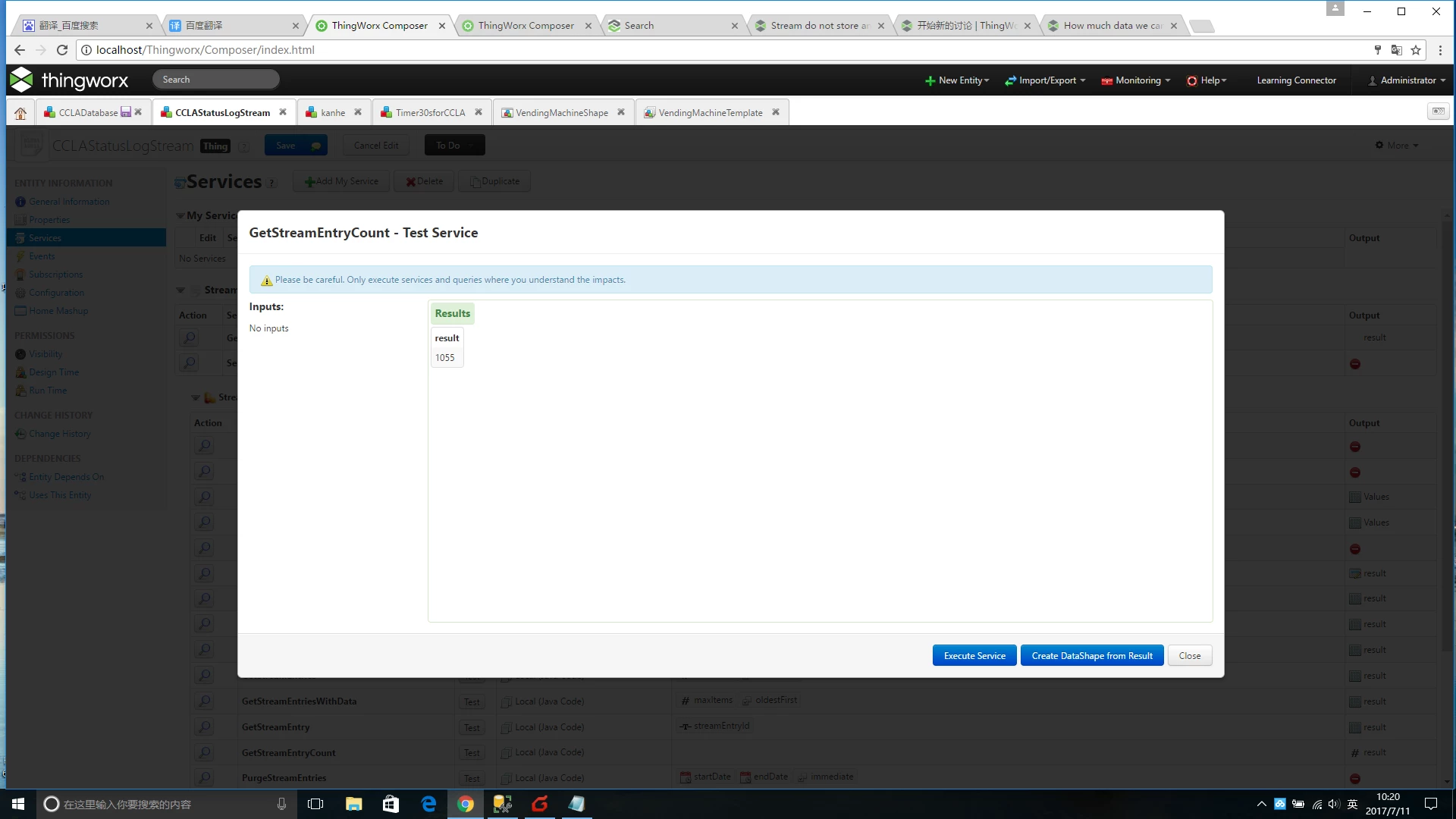

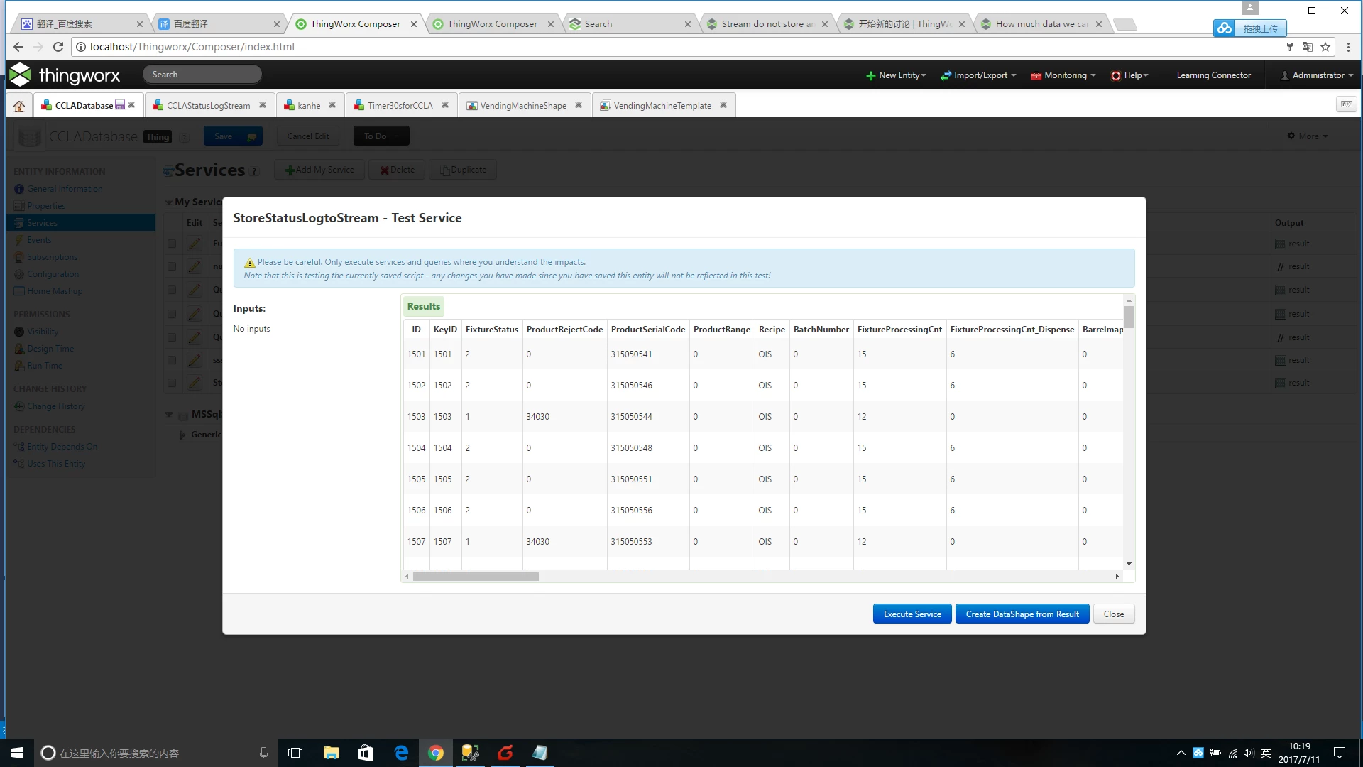

   I have a database in local,and i have to put about a million rows data from database into stream of thingworx, so I create a query service in a database thing,as we know the query service can only query 500 rows at a time,so I create a service to store data to stream: in this stream,I store one row in one milliseconds to the stream,and for four times to store 2000 rows.
However,after store to stream,I find only about 1000 rows store to stream.I can't find the reason.Please find the attachments.
