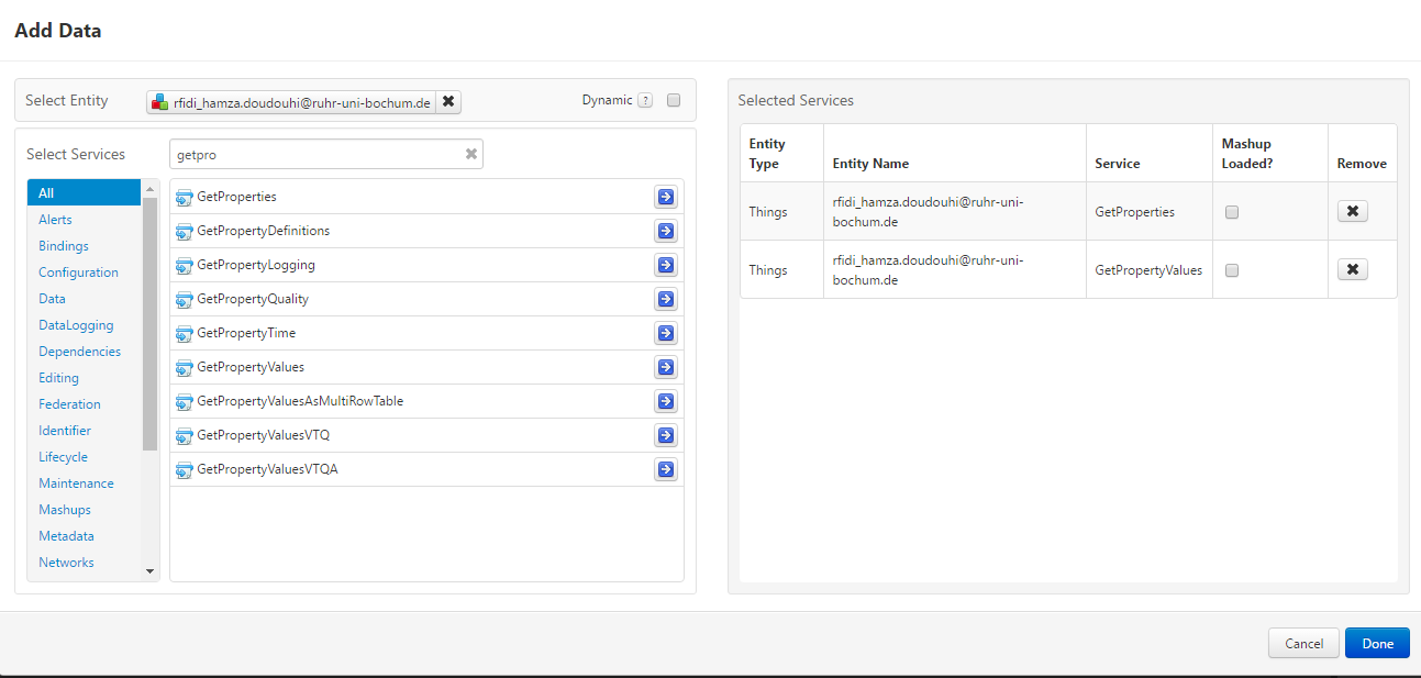

Hallo,
I can not see the properties of my created Thing in Mashup:
I dont get why, when I add a thing i can choose it and call getproperties() or getpropertyValues but it wont work!

hdoudouhi1-VisitorAuthor
September 1, 2016

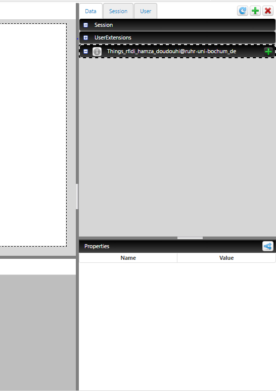

The binding is above and it wont show the getproperties under the generated thing.
also when i press done button it wont disappear as usual when u add a thing with services to the mashup but it adds it as shown in Pic 1.
the weird thing is that i can do it with another Thing, which is created by another specific user, who does not have his email as Username.
i have also installed the nameAutoComplete extension.
thanks for your time and help

September 19, 2016
It looks like the mashup builder's hitting an exception, which is why Session and UserExtensions are showing up above the Thing.  You may want to coordinate with PTC Tech Support and see if this is a bug.
