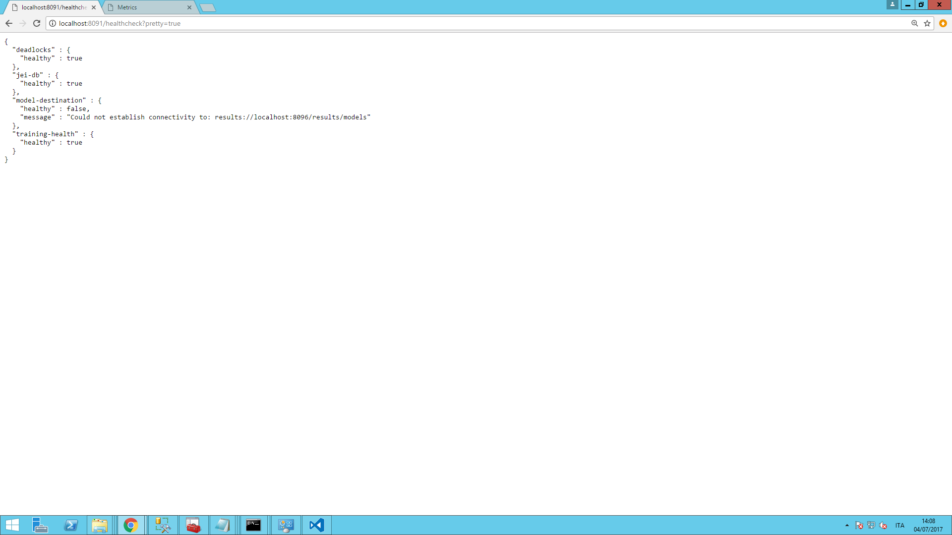

I'm in truble with anomaly detection, here is my state:
The microservers Result and Training started properly.   (I believe)

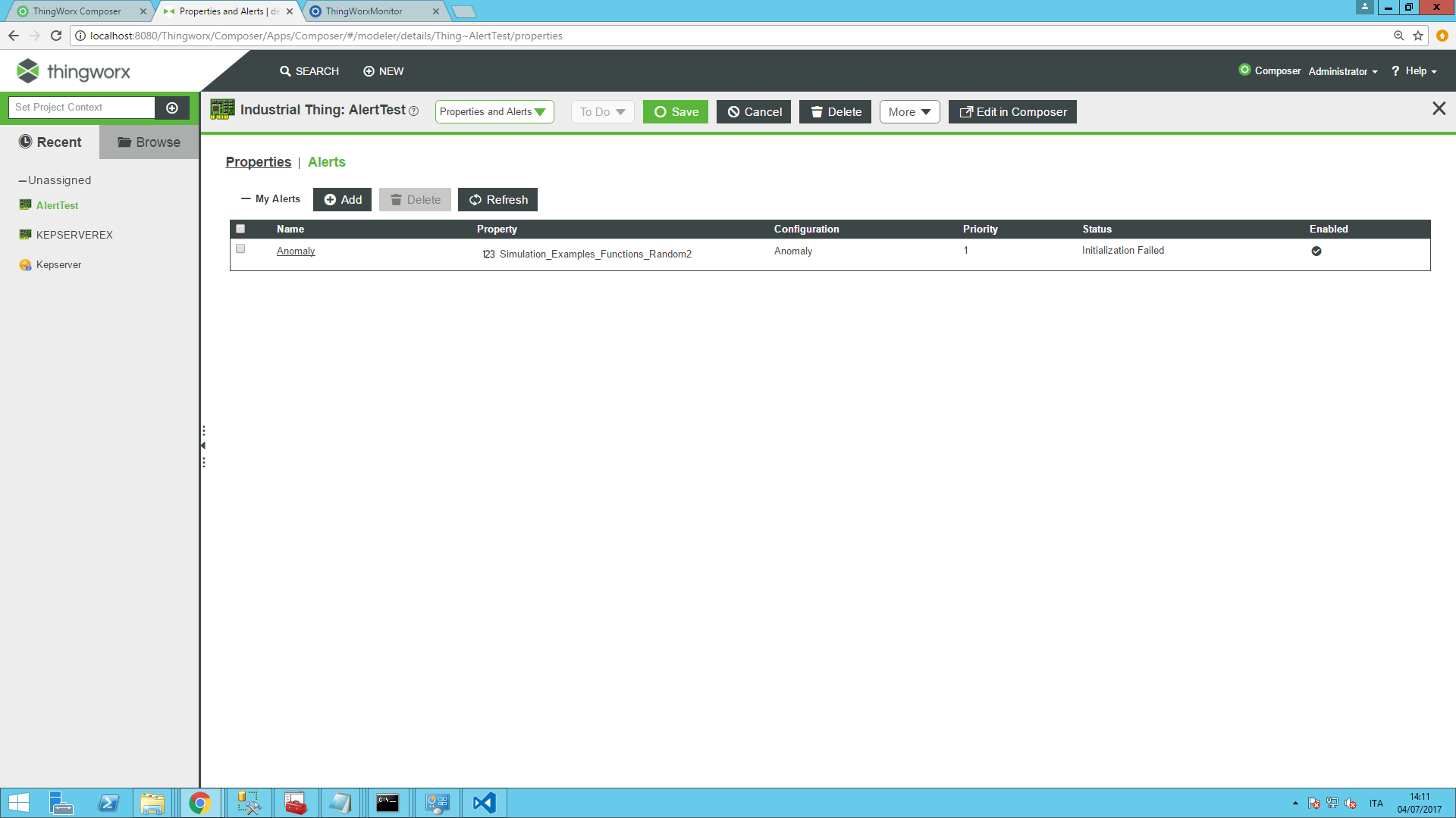

I tried to start an anomaly detection from simulated device by kepserverEX in the new composer, but gave me initializaztion Failed.

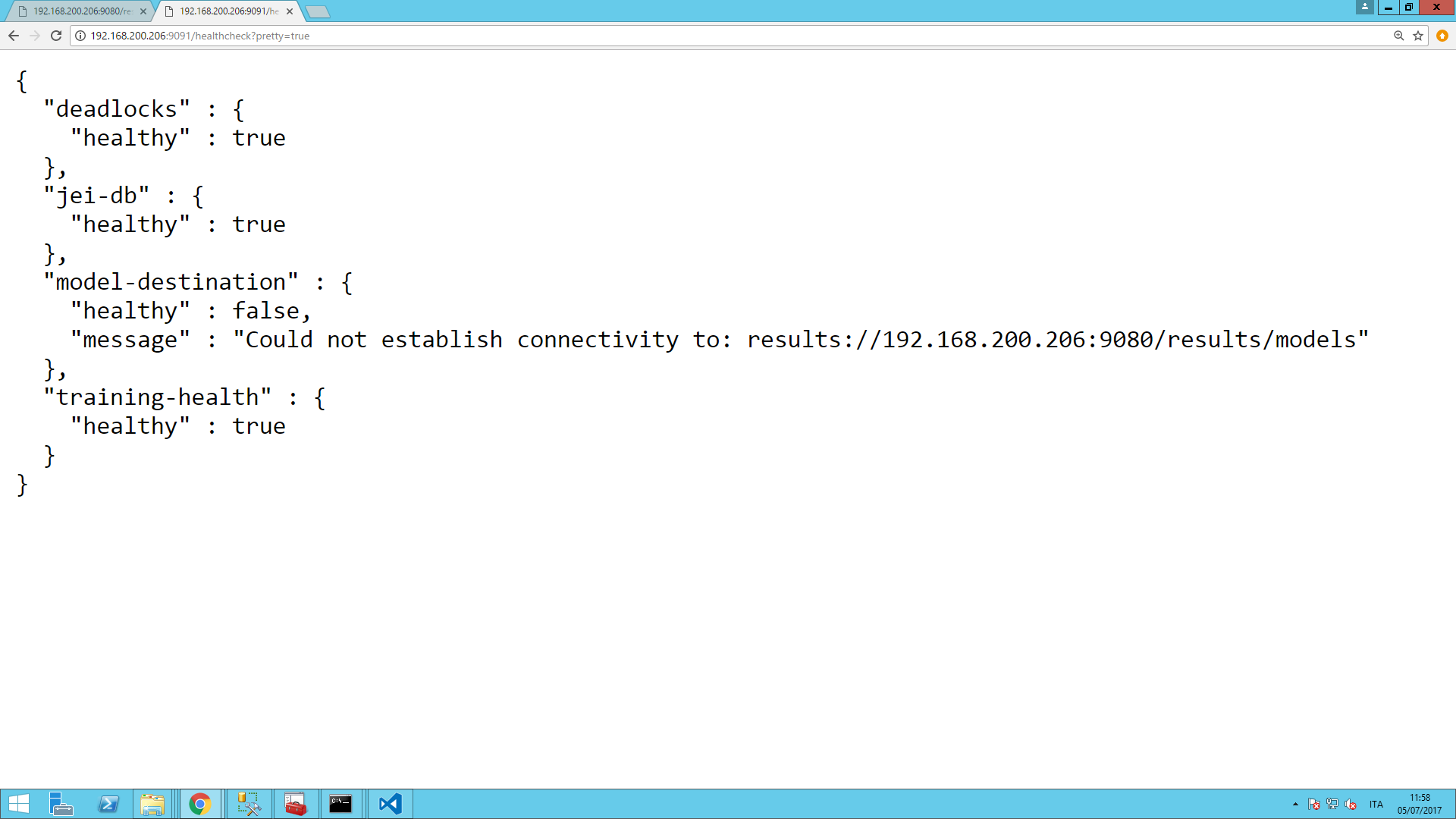

I notice this error in training/Healthcheck:     (localhost:8091)
"model-destination" : {
  "healthy" : false,
  "message" : "Could not establish connectivity to: results://localhost:8096/results/models"
I noticed that:
Thingworx , microservices are in the same PC.
any suggestion?

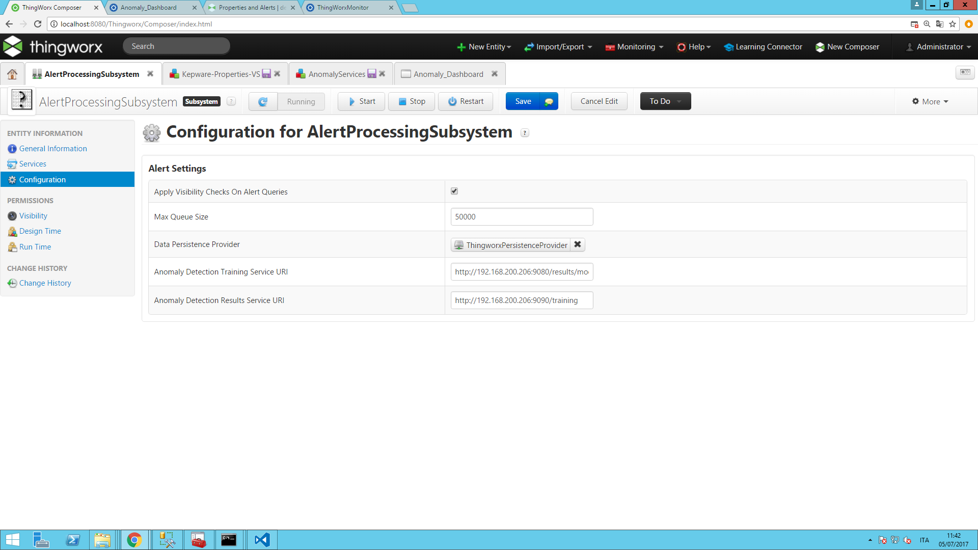

So I put those end point in the AlertProcessingSubsystem

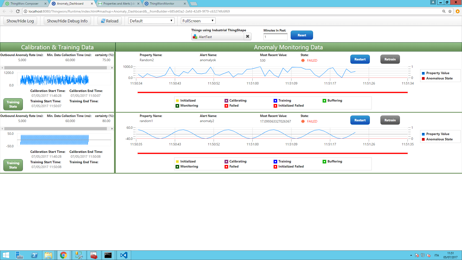

Started anomaly detection:

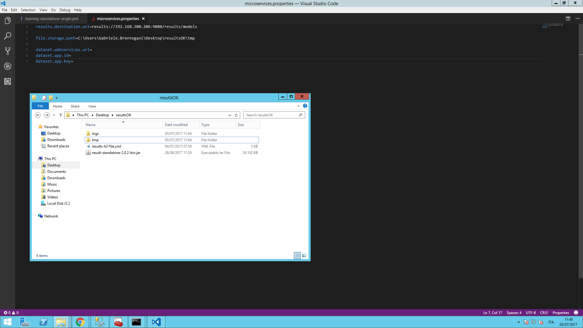

my microservices.properties is:
The anomaly detection always fail :
Application log from Thingworx  give me some errors:
ERROR:  Anomaly Alert [AlertTest-Random2-anomalyok] Failed when in [TRAINING] State. Thingwatcher Error Code :: [WAT9999E]  Message :: Unexpected exception. {Throwable=[NonRetryableTrainingRequestException: Received error from POST of Training request with Code(415)_Message(Unsupported Media Type)_Details:_{code=415, message=HTTP 415 Unsupported Media Type}__}]
ERROR: Anomaly Alert [AlertTest-random1-anomaly2] Failed when in [TRAINING] State. Thingwatcher Error Code :: [WAT9999E]  Message :: Unexpected exception. {Throwable=[NonRetryableTrainingRequestException: Received error from POST of Training request with Code(415)_Message(Unsupported Media Type)_Details:_{code=415, message=HTTP 415 Unsupported Media Type}__}]
ERROR: Returning a FAILED state for TimedValue [timestamp=1499248207445, value=7.421176433563232]. ThingWatcherMessage [timestamp=2017-07-05T11:50:08.639, severity=ERROR, state=ThingWatcherInternalState [internal=TRAINING, external=TRAINING], messageCode=WAT9999E, messageText=Unexpected exception. {Throwable=[NonRetryableTrainingRequestException: Received error from POST of Training request with Code(415)_Message(Unsupported Media Type)_Details:_{code=415, message=HTTP 415 Unsupported Media Type}__}]]

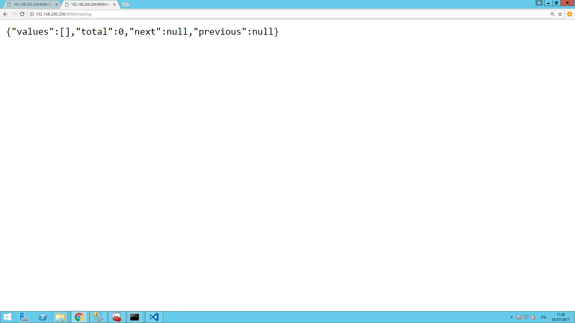

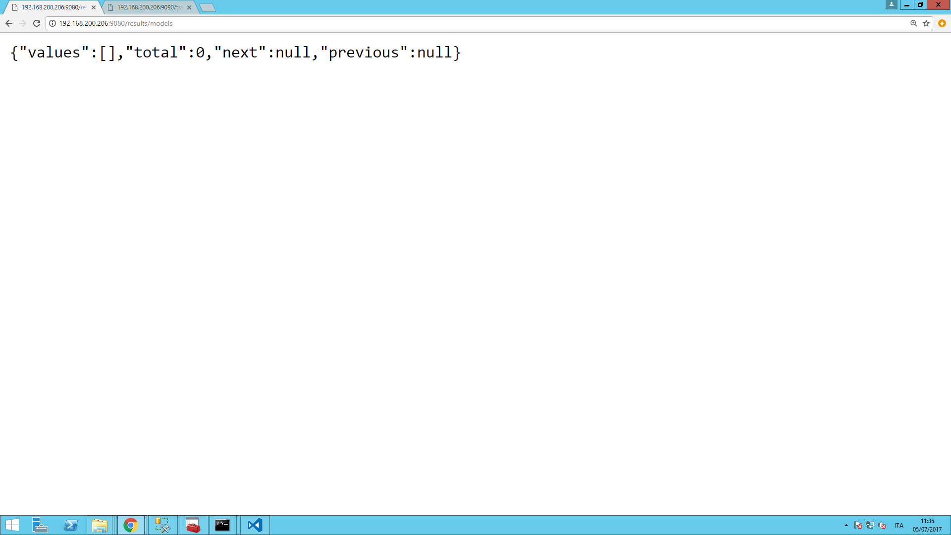

Then I checked training healtcheck:
Could this be the cause of the problem?

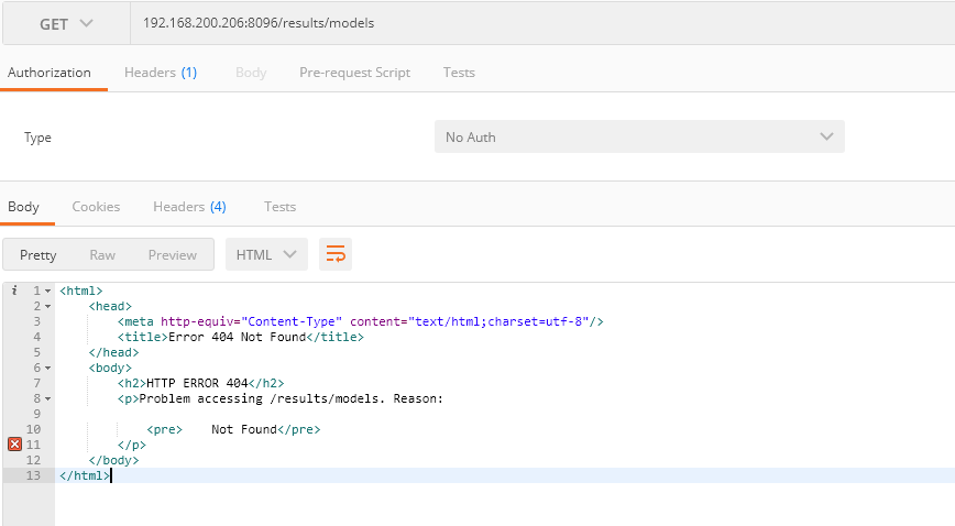

How can I fix the ("message" : "Could not establish connectivity to: results://192.168.200.206:9080/results/models")?
Thanks a lot!!

2 things:
1) in the alert subsystem you have the training and result uri swapped. You need to change this and restart.
2) in microservices.properties for file.storage.path could you set only a relative path. I seem to recall having problem when having a full absolute path. I was running successfully with simply file.storage.path=TWatcherStorage . A TWatcherStorage folder got created where the jar files are (not the folder name can be anything but use only ascii characters)
Hope this helps.
